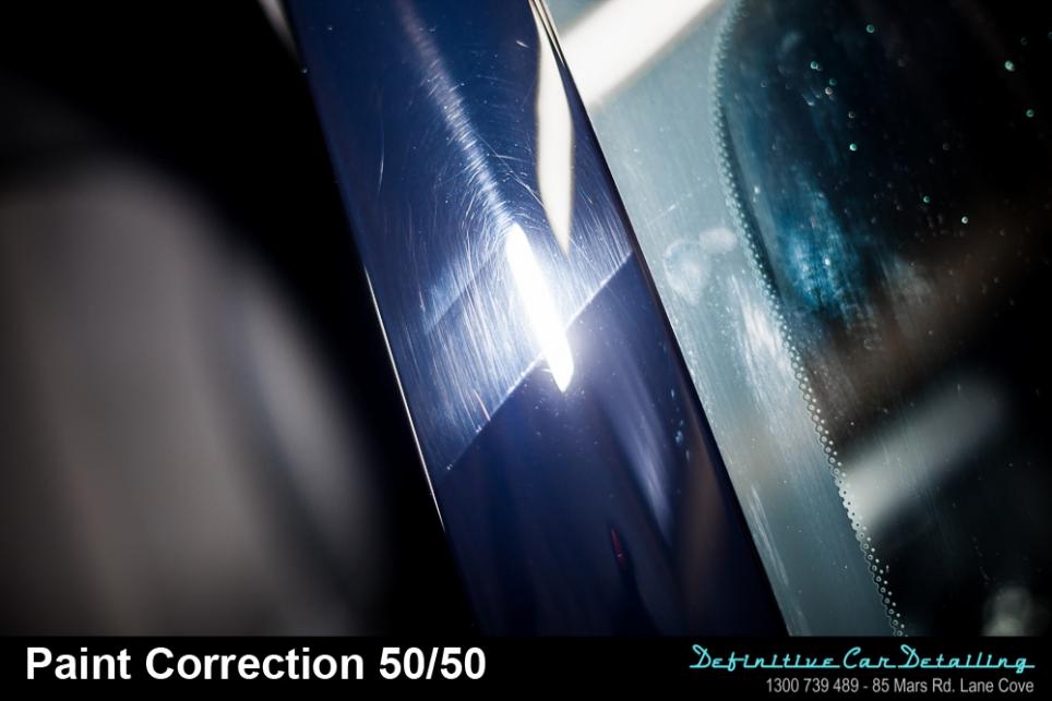

The car has piano black finish from the shoulders up & is super easily scratched. Everytime I see one I always check & have not seen one that does not have scratches...
Rest of the car also has isolated holograms.
The paint correction process on this car was more difficult than normal, some areas had to be cut hard then finished softly as even Hyper Polish with Rupes Green Pad was leaving marring on the piano black surfaces.
Paint correction started with Zentool, Rupes Green Pad, Hyper Compound on worst areas. Followed by Rockwell, CCS White, Optimum Finish on piano black areas.
