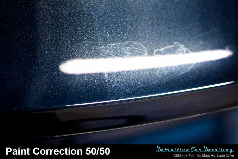

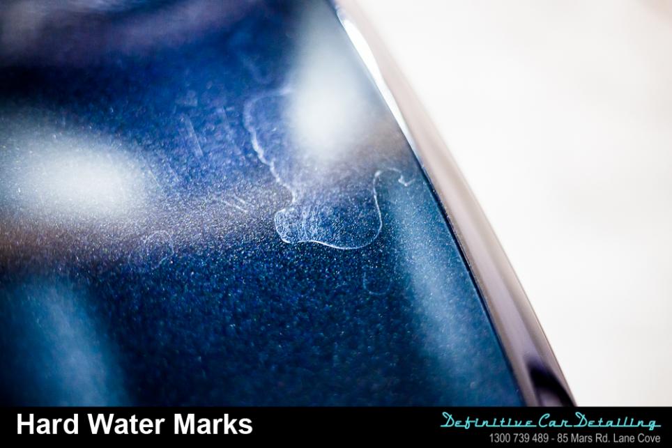

Car had significant hard water marks on the rear trunk lid.
When it comes to water marks, the first is to establish whether it is "hard" or "soft" water marks.
Soft water marks can be removed by chemicals such as CarPro Spotless. Hard water marks on the other hand can only be removed by abrasion, such as Clay Bars, Polish or Compound.
4 series seems to have hard paint, paint correction was done by Zentool, Lake Country Purple Wool, Optimum Hyper Compound. Followed by Rupes Green Pad, Optimum Hyper Polish.
Any questions please ask. Enjoy the pics...
