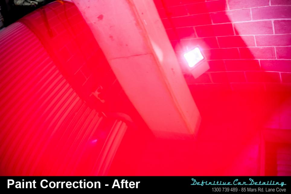

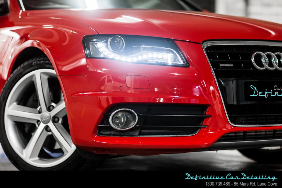

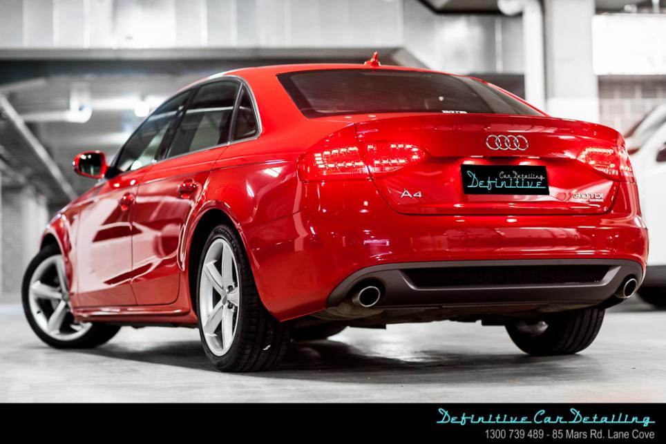

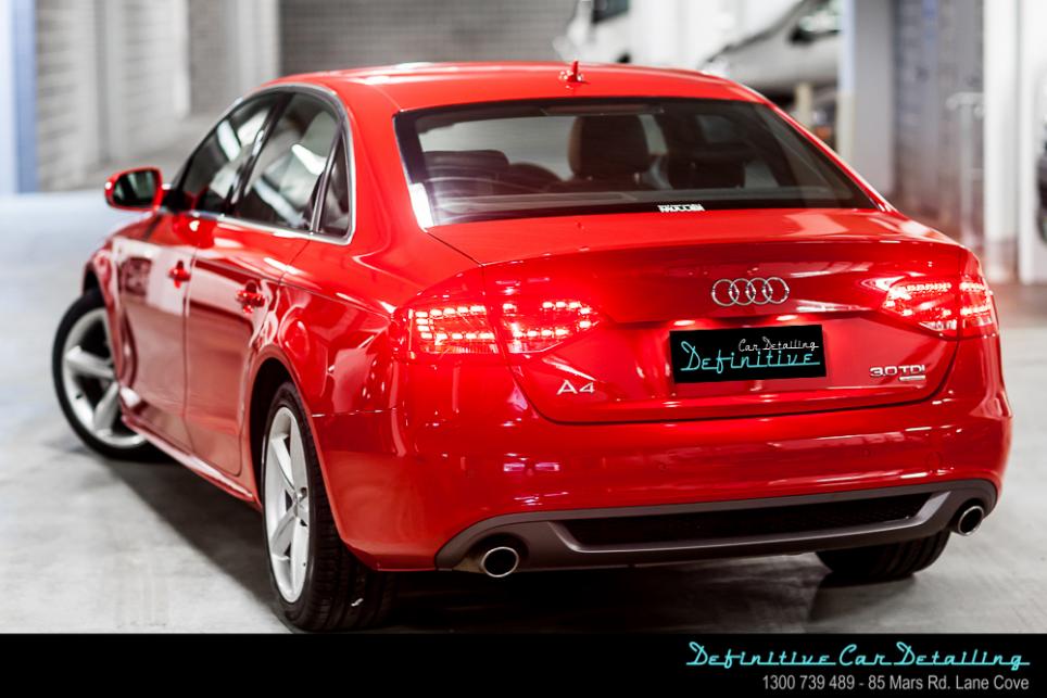

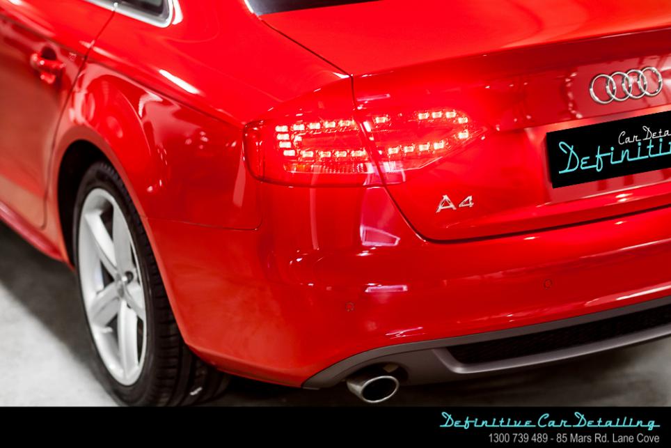

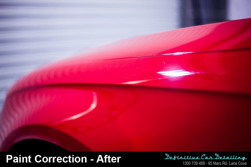

    Audi A4 in Red.

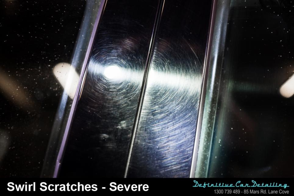

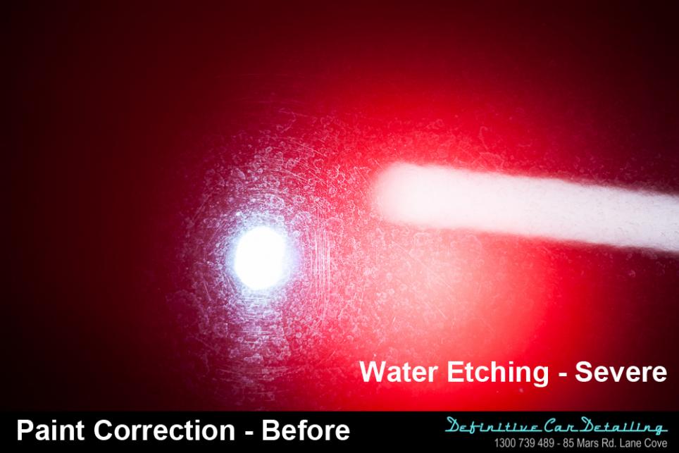

    Car was in a terrible condition, with severe water etching, sever swirls, and covered in contaminants. It turns out the car had been washed using water from an underground supply.

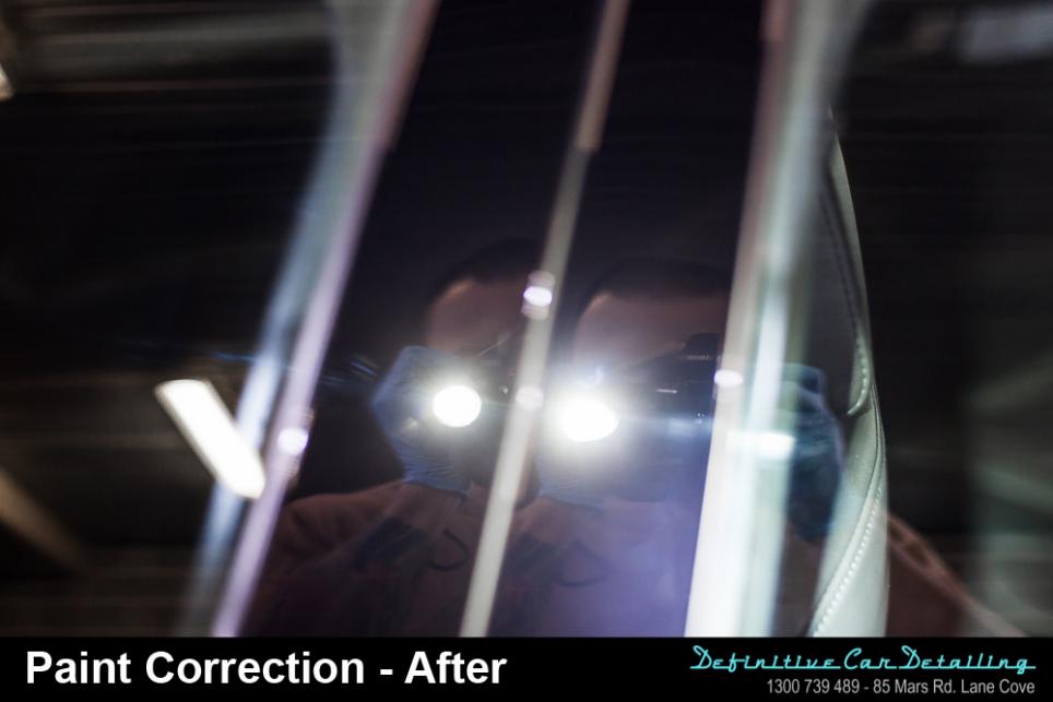

    Total time of more than 30 hours just in paint correction. Started with Wool on Rotary, Blue Rupes on Zentool, then Green Rupes on Zentool. Absolutely complete transformation.
    Enjoy the pics...
