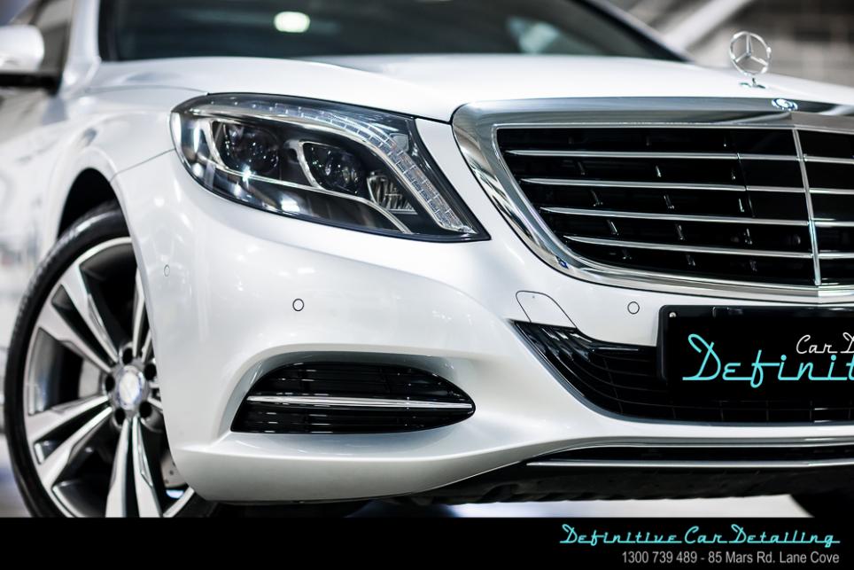

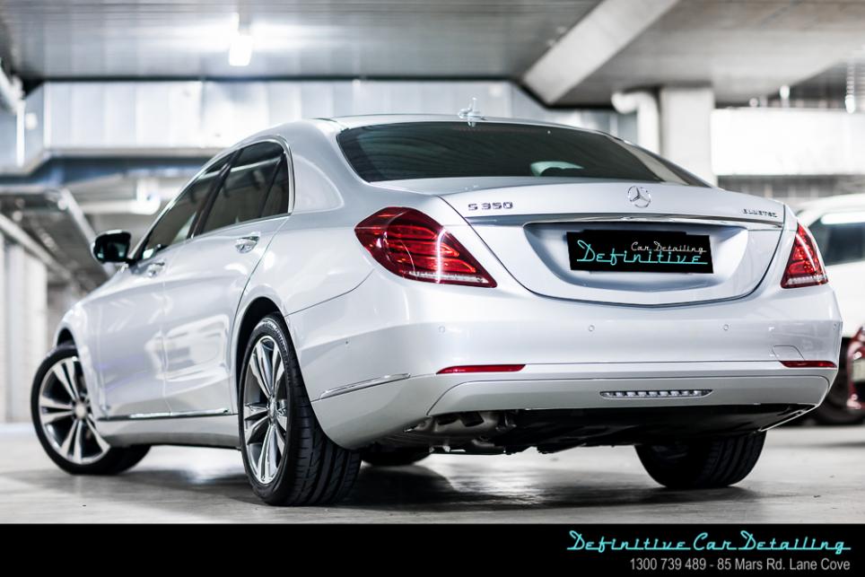

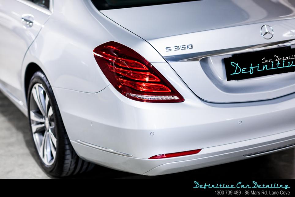

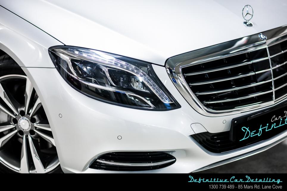

Mercedes S350 in Silver.
No extra paint correction required other than on the B-Pillars. This car also had very hard paint, even harder than CeramicClear in my opinion, polishing the B-Pillars took 3-4 times longer than normal using Zentool (21mm DA), Orange CCS, Optimum Polish, Optimum Finish.
Paint reading was also not high like previous gen S Class, average 120 microns.
Love the new S Class! Enjoy the pics...
