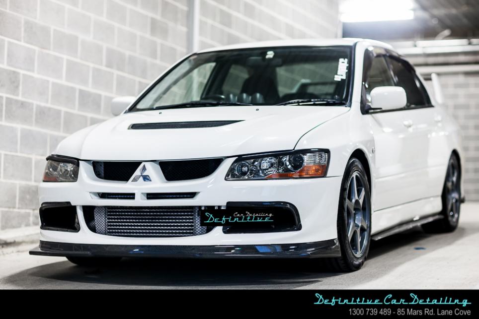

    Mitsubishi Evo 8 in single stage white.

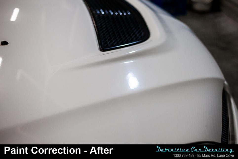

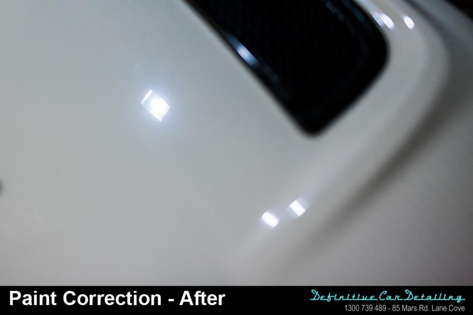

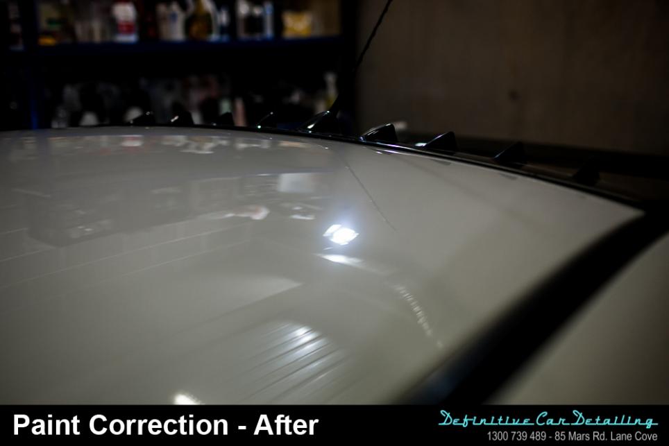

    Severe swirls & some holograms. When I first started paint correction, the plan was to do a 2-step, starting compound with wool on rotary then finish on DA. However the paint was so hard it required at least 2-3 passes with wool on rotary then purple foam wool on Zentool to finish.
    Swissvax Concorso used for LSP. The owner has big plans for this car in the near future, including a complete respray.
