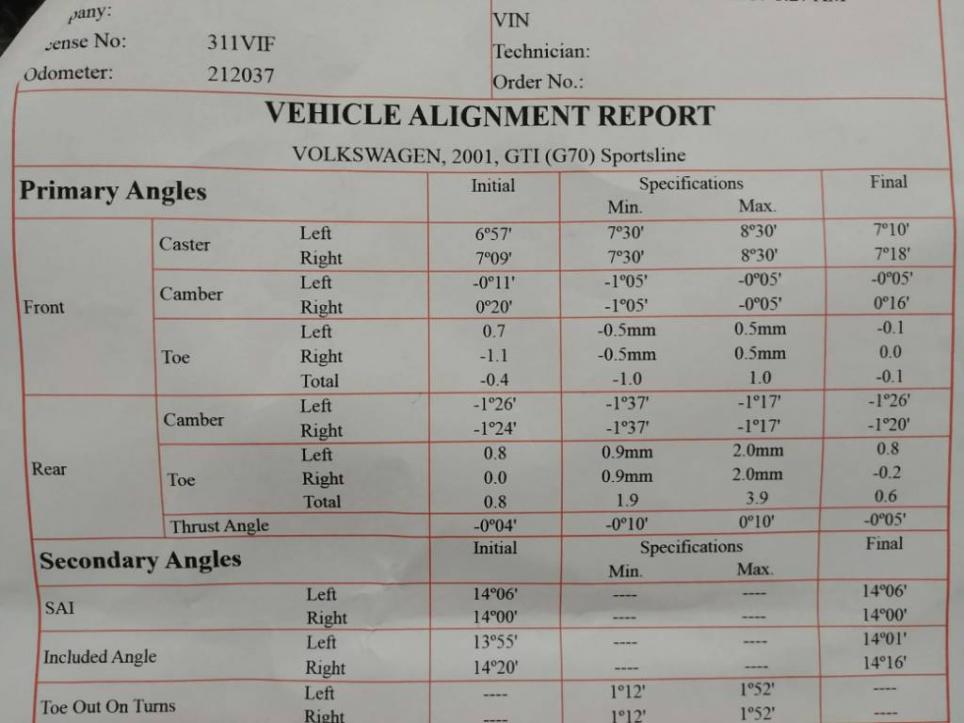

    Current front camber: approx 0 deg
    Current rear camber: approx 1deg25 both sides. Refer to alignment sheet.

    I've run everywhere from 2/1/4 down to 1.5 degrees neg. You will get accelerated wear doing street km's on the inside of the fronts with anything over 1.5. If your tyres are symetrics you can just get them taken off the rims when they are getting down and swap your left tyres to the right and vice versa to get a fresh tread down on the inside. That'll buy you more street km's.
    On the track a general rule of thumb is the more castor you have the less camber you'll need. You've got a good amount of caster there so you could get away with 1.75 degrees eg as a street/track compromise. I wouldn't choose your camber based on will I/will I not oversteer in mind. Your choice to remove the front bar and run the rear with 24mm will be the main bearing on that. I'd still personally still run a soft front bar. I'll try to dig out some pics of a Polo guy who was photographed through the same corner with/without the front bar connected and the front roll without was pretty dramatic. What I've found is when the car starts to lift the inside rear (which is what you want if you have a open diff) if the front opposite corner cant support the load (which it will find it harder to do with no bar) then it can start to really plough. eg on smooth flat tracks when running my front bar on hard I have to be more careful not to understeer on corner entry, but if I get that right it'll three wheels nicely through the apex and be quicker overall. On soft the front end will tip into corners with more reassurance and get the power down harder on exit, but its easier to overcook it at the apex. At proper tight hilllimbs ill always run it on soft though.

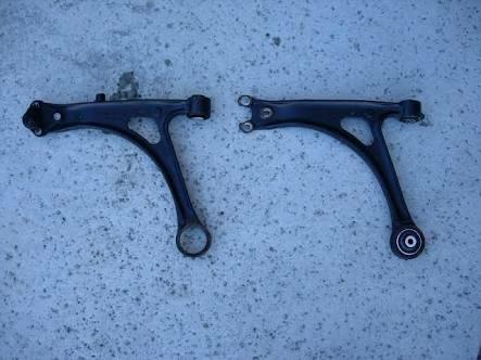

              The mk4 GTI comes with a 21mm fsb and nothing on the rear. **** Shine says that the removal of the front sway is 'a good experient' if front springs are 300lbs or greater. He does say to warm up the rear tires thou because it's very prone to oversteer. I've emailed the company I ordered my springs from to get the exact spring rates. I could be wrong that they are 300/200.
              If I'm running a 24mm on the rear currently, what is considered a smaller realistic option on the front. I think the stock TT is 20mm. I wonder if I could get the tabs welded onto my struts to fit the sway bar...
              Originally posted by GeorgeMK1 View Post
              You also mention you aren't able to run a sway bar?
              The mk4 attaches the sway bar end links to the control arms where as the TT connects the sway bar to the front struts. I don't have the tabs on my struts to connect the sway.

                I think ideally for a pretty good street setup, the standard front sway bar with an oversized rear sway bar would be a great starting point. From there you would be able to find out what you are happy with and how it handles to your style of driving.
                In regards to your end link issue, I now know what you mean. Ideally, welding would be the best idea as that is how it is from factory. HOWEVER, welding a strut full of fluid/gas is never a good idea. I have another solution for you - Its a company called Dorbitz Designs. He basically makes brackets for struts that come with no endlink support. MK6 air struts from bilstein have has no front sway bar tab like my OEM struts do, and his kit allows me to use end links to re-attach the sway bar.
                Its like a clamp that goes around the strut. Have a google, I'm almost certain he makes MK4 brackets too. Hope this helps

                  Looks like you might be able to get out of trouble regarding getting endlinks sorted. I know from some of the british hillclimb sites where small hatches are very popular that guys do run sans FARB but they are on 450+ front springs and like you found they are doing it to maximise traction under power when going uphill in a FWD which is an inherent drama. I know from a theory and personal experience at hillclimbs/sprintst point of view that anti roll bars really help with rapid changes of direction - that delay you're feeling probably is the absence of the bar, but it may not matter if your on a track with wide sustained corners as opposed to chicanes and switchbacks.

                      The cheapest solution at the moment is obviously to fit nothing. But otherwise it would be to find TT control arms with the nubs to fit the stock mk4 sway. See pic..
                      But the TT gear is just so superior, I might even consider replacing my front struts with the TT struts so I can run the TT sway bar. I just wish I thought of this when I first bought these struts.

                              I've had a number of people tell me that I can have the sway bar tabs welded onto the struts. I am assuming I have have to remove the gas strut from its housing before actually commencing the welding?
                              How Shocks Work - Access Bilstein strut internal bump stop (3/7), v2.30 - YouTube
                              Regardless I'll continue with the Audi TT transplant on the 12th with the tt sway bar installed without the end links and then I'll sort out the struts.
