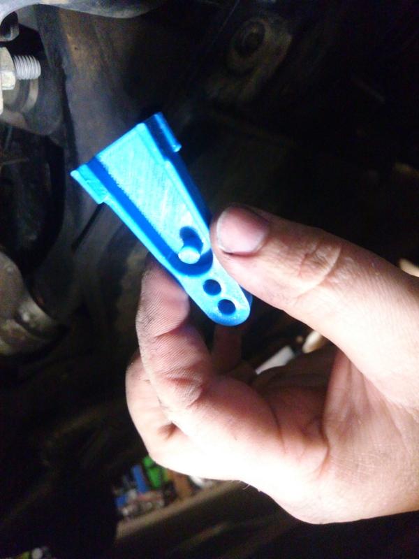

I then designed an extension piece for the stock arms which could be 3D printed in abs plastic. I designed it to clip in place, so no fasteners required.
I also decided to add 2 extension positions, so they could be used to extend the range of air suspension travel either a moderate amount (25%), or a lot (40%).

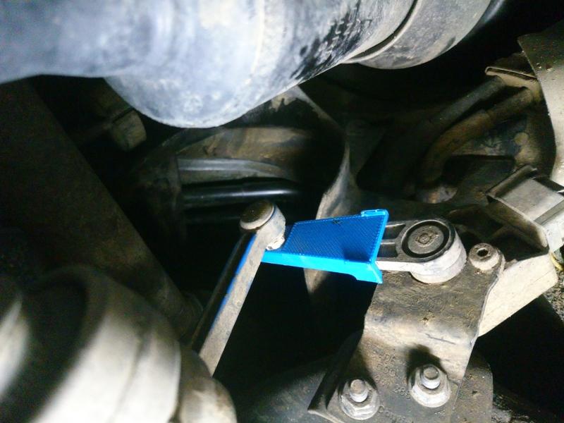

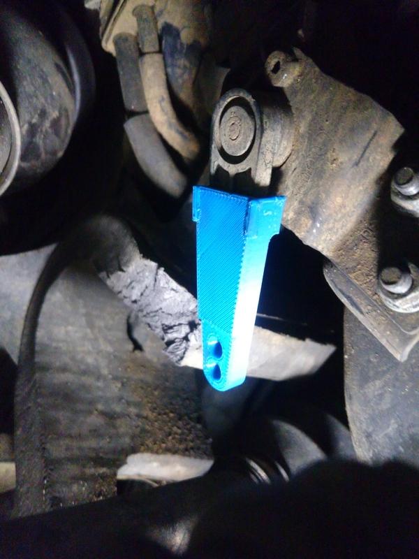

Heres some pics of the front drivers side install..
All these do is decrease the angle through which the sensors move for any given amount of suspension travel... Therefore increasing the overall travel range.
