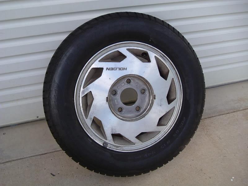

    need a photo the back of the wheel before I could even geuss,. ring up any tyre/rim place (tempe tyres maybe) and they should be able to tell you the offset.
    More IMportantly though, you have BBS's why would you want commy rims for?? I'm not sure they'd work (lookswise)
      not exactly calais wheels but you get the idea

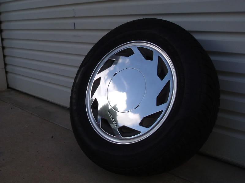

        They would definitely look cool. Some of the older Holden/Ford wheels actually look OK, with low profile tyres and a good polish.

          it can be done but depends whether theres room on the rim to do it.
          if its a 4 stud, then theres room to redrill an extra 4 studed pattern. shouldnt cost that much either, $20 a rim or so.
          i owned a multistuded wheel before, tyre place drilled it wrong then redrilled to suit.

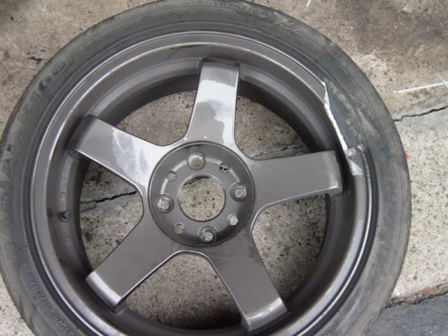

          example:
          looks like the 5 studed pattern cant be done, no room.

            yes... those are the wheels im gonna try it on
            throw a 165/50 R15 on them.....
            my plan is to paint the inner grooves black and polish the tops
            not too sure about the holden logo tho
