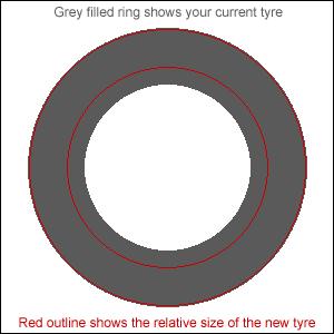

    then come across this beautiful tool on the car bibles
    this one showing my current 185\60\r14 (grey) with 205\40\r17 which is a tyre size that is available and would fit a 17x7 rim as far as I understand...
    So if a 205\40\r17 and a 215\45\r16 and a 185\60\r14 all have very similar rolling distances and size why can't I have the 17"?
