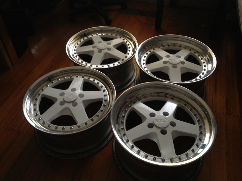

    well wobble bolts need a clearance of atleast 15.8mm to allow enough play to mount the wheels.
    These wheels are unfortunately only 14mm so i was just wondering if you guys know any places to drill out the holes and possibly what price.
    thanks in advance!

      I had my Rays wheels bored out from M12 to M14 at Eastern Wheel Works. Friendly, helpful and reasonably priced too.
      Wheel Repairs Melbourne

        I'm using wobble bolts and they need that extra bit for clearance to be bolted in properly
          Yeah, just sounds a bit much is all...

            you're trying to fit these to a 5x112 car, right?
              Yeah they're 5x114.3
              Fitting them on a 5x112
