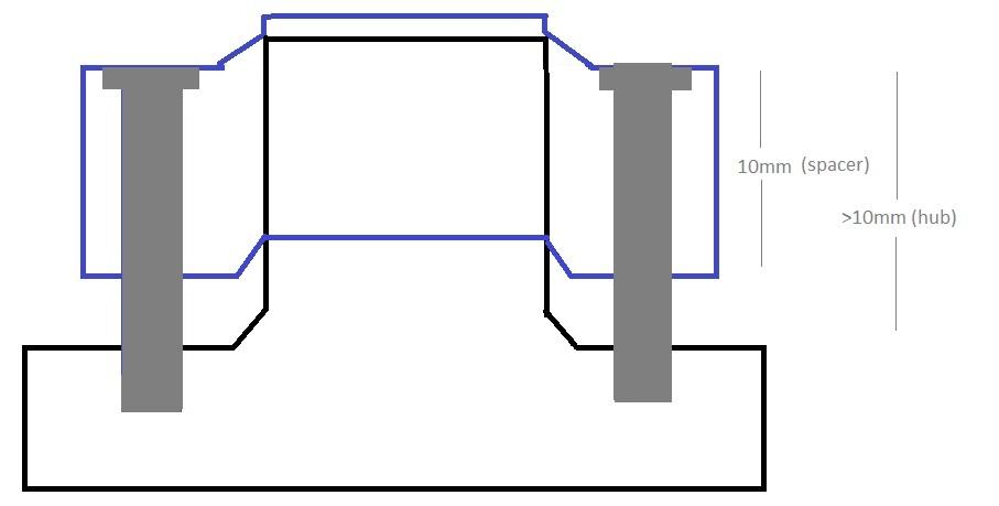

This is what I was saying from the start. I originally bought 10mm wheel/hub centric spacers and realised that my hub protrusion was longer than 10mm (that's why I bit the bullet and got the spacer's wheel centric part machined off). Obviously this means the spacer doesn't sit flush - you'll have a problem no matter what brand. When torqued up and the car is static it would feel tight, but disaster is lurking in the shadows.
IMO this spacer broke because of human error. The title is misleading and is just fueled by brand snobbery. All the spacer balanced on was the hub protrusion with no support on the outside and with lateral forces of course it would strip the bolt threads and snap in half.Last edited by kapowww; 12-11-2012, 09:30 PM.
Sorry but I don't understand either of your points - can you add some pics or diagrams to further illustrate what you are trying to say?Resident grumpy old fart
I understand what he is saying. I will take some of the blame for this breaking, I should have got the vernier calipers out checked more thouroughly that they were right. I know brands like adaptec can make 10mm ones that will work but these were obviously off by just a little bit (less than a mm probably). When I put them on the car they looked like they were sitting fine, but obviously they weren't quite right.Last edited by Ben J; 12-11-2012, 09:53 PM.sigpic
Yeah it's hard to explain but I tried to draw a crappy picture in good old Paint to try and illustrate what I'm saying.
I don't think 10mm would work regardless of the brand. If you're going from 57.1mm CB to 57.1mm CB no matter what happens you can't fit more than 10mm of hub in there.. Please correct me if I'm wrong but I can't picture a working 10mm hub & wheel centric design.Originally posted by Ben J View PostI understand what he is saying. And yeah I will take some of the blame for this breaking, I should have checked more thouroughly that they were right. I know brands like adaptec can make 10mm ones that will work but these were obviously off by just a little bit (less than a mm probably). When I put them on the car they looked like they were sitting fine, but obviously they weren't quite right.

Christ! There's no way that would work but I would have thought it's be pretty obvious too, when you tried to fit them on, even if you have hugely exaggerated the gap in your pic.Originally posted by kapowww View PostYeah it's hard to explain but I tried to draw a crappy picture in good old Paint to try and illustrate what I'm saying.
Originally posted by Ben J View PostI also wouldn't be overly concerned about not running wheel centric (I'm actually currently using non wheel centric spacers in the back)The big chamfer around the hub on a good hubcentric spacer does help locate the wheel and transfer load - it's better than nothing. For sure, a wheel centric spacer won't work if the spacer thickness aproaches that of the hub protrusion (unless you go to a larger centrebore)Originally posted by Ben J View Poststay away from 10mm hub and wheelcentric spacers in general.Last edited by kaanage; 13-11-2012, 09:08 AM.Resident grumpy old fart
