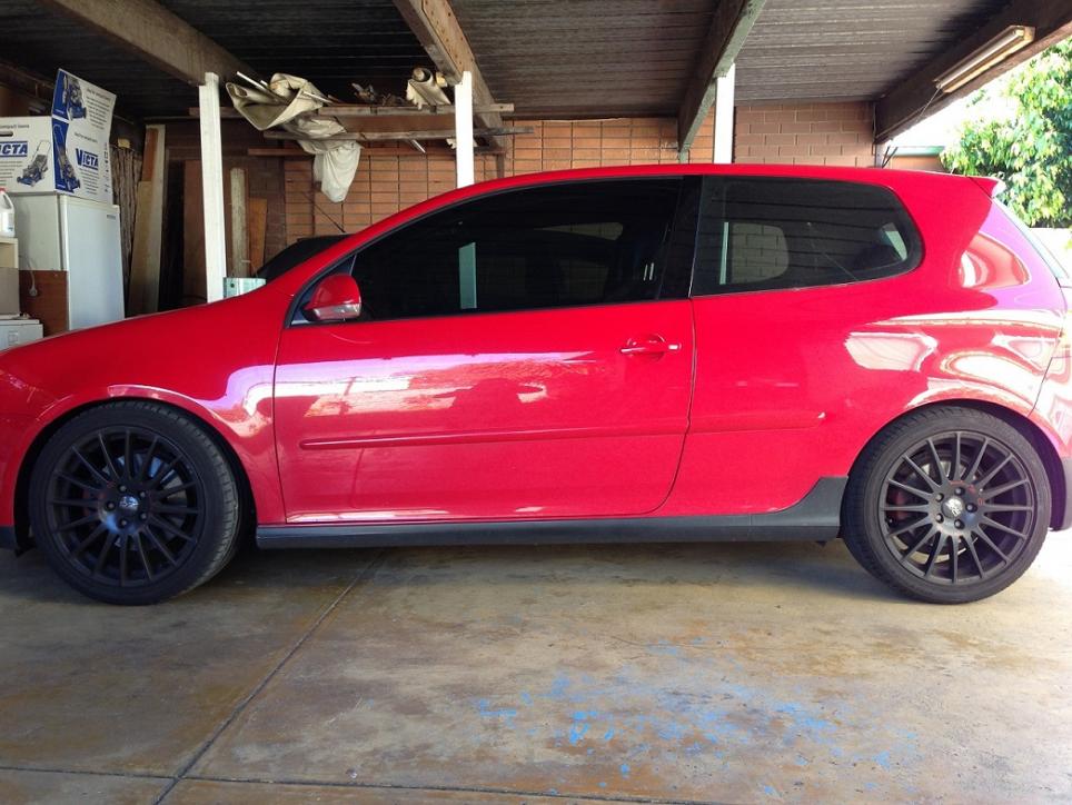

    Hi guys,
    I have an 2008 Golf GTI, with koni FSD and eibach pro kit. However after they were installed I noticed the rear didn't drop at all, whereas the fronts did.
    Granted my car is a 2 door so it would be lighter in the rear however, it should have made some difference right? I installed this around 1 year ago and has had 2 wheel alignments since.
    What is the cause of this and is it fixable? if not, Im considering Eibach sportline, and H&R super sport. Which would be the better choice in my situation?
    Thanks
    im sure you have checked but..
    rear springs right way up? in the right position?
    have you checked the part number on them compared to others?
    Just throwing stupid ideas out there...
    I know some people are not happy with the drop as there stock suspension has already sagged 15mm or so before the new springs go in. but it does look a touch too high...
      seems correct to me, though i'm no expert...
