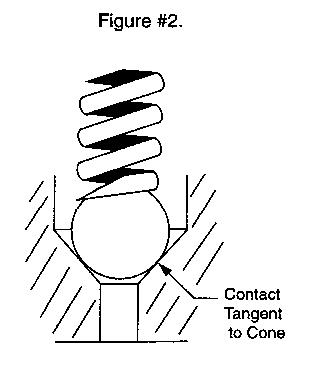

    What are peoples thoughts?
    I always understood it was a no no because there wasn't enough contact on wheels. putting more strain on one point of the wheel. But seems some people think different.
    Refer below image.

    It'll work short term but the extreme pressure on the wheel seat will deform it (3000 series aluminum is much softer than steel), creating clearance => loosening off over time.
    So unless it's an emergency, it would be silly not to buy the correct bolts or nuts.
    Plus it buggers the seat for when you use the proper fasteners.

      Im also interested on peoples opinions on doing the opposite, conical seat bolts on ball seat wheels? I bought some spacers and extended bolts for the BBS im still building, but just put the spacers in with the stock wheels for the time being, using the conical bolts on the ball seat wheels. Haven't actually driven with it like this, just taken photos, but how unsafe would it actually be?

        Realistically, I think you'd be pretty unlucky to have something go wrong. But I'd still use the correct bolts for peace of mind
          It damages the seat. Ive seen people use conical bolts in a ball seat wheel and they eventually wear into the new shape as they get hit with a rattle gun by your local mechanic/tyre fitter.
          I would think the only danger is as kaanage says the bolts may loosen over time as the surface wears.
          If youre gonna do something. Do it properly.

            It does not matter either way. Use the correct bolts.
            The amount of deformation that is needed is very small, and this will see the bolt loosen. You may not be able to detect it with your fingers, but when under load, there will be free play.
            It is not a case of if, but when.
              wheel bolts are something I don't want to muck around with.
              cheers guys, confirms what I thought!
