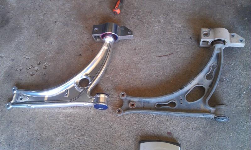

    Installed these on the weekend:

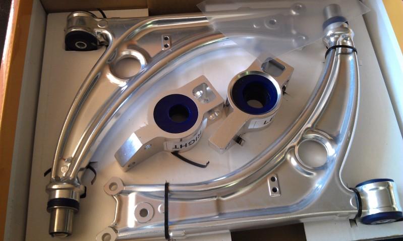

    ready to install:

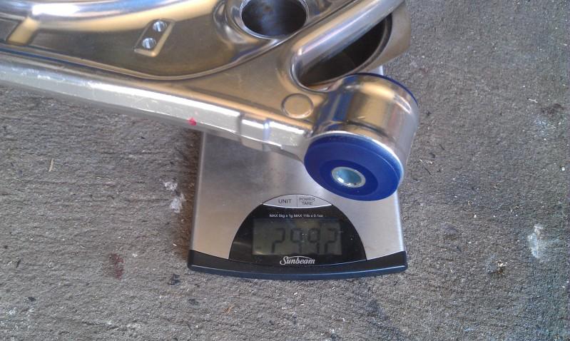

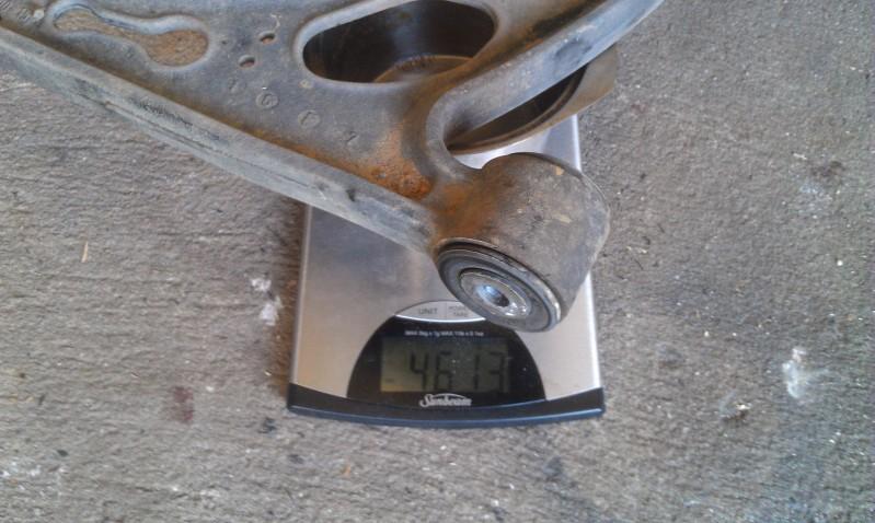

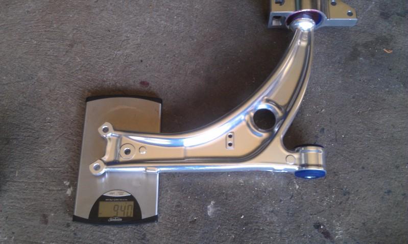

    weight comparison:
    stock arms and bushings
    and the outer part:
    superpro arm and bushings
    and the outer part
