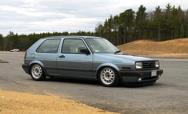

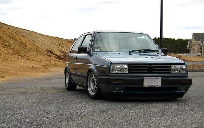

                    i just read in a forum on vwvortex that et/offset is backspacing.
                    also i just saw a few photos where they guy is using the same rims as mine. now im thinking i might just run them as is!
                    looks sick imo
                      Go large or go home.
                      15 x 8 et0
                      Centres are G60 Corrado steelies.
                      Eastern Wheel works made them up for me. Wheel Repairs Melbourne
