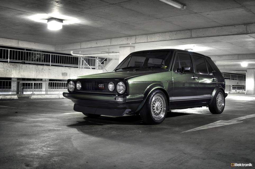

              You need to roll your guards if you go low, on 195 it tore them to bits before they the guards were 'trimmed' with a grinder (but I had GTI flares on as well that needed to be cut as well)
              Here is my car with the 15x6.5" BBS with 195/50
                if you want to go low, get the 185/45 to avoid issues.
                if you want to go really low and spacer hte wheels out a bit, get 165/50.
