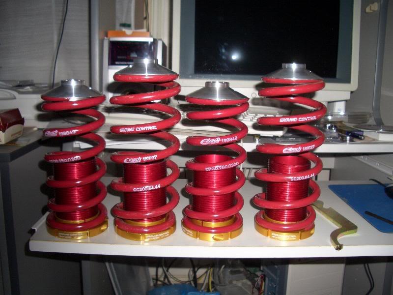

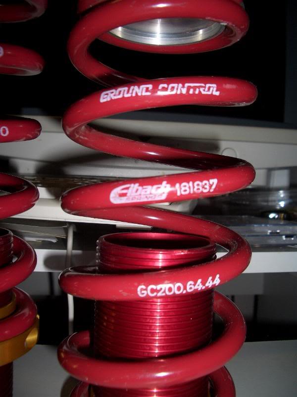

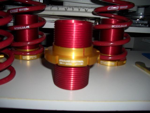

    I'm currently going to run Koni struts with Ground Control sleeves running 300/250 lb F/R Eibach springs. They will be height adjustable from 0"-2.5" so they will be ideal for street and/or track. They're being sent from America right now; I have heard from many sources that they are great on the autocross as you can custom order the spring rates. Eibach makes them specifically for the GC kit. The Konis are damper adjustable.

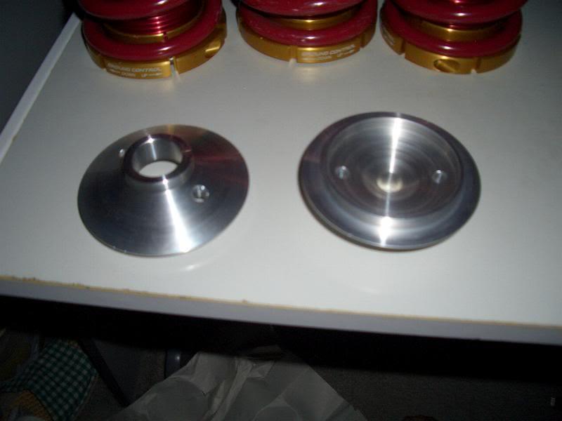

              I got my GC sleeves today. Will be installing them this weekend ; )
