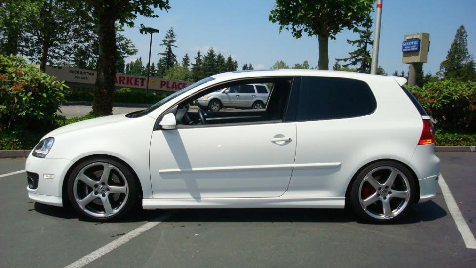

      18", if u go for a conservative width and offset, ie: OEM Detroit 18x7.5 offset +51 to OEM Karthoum 18x8 offset +50, imo the Mk6 GTI will look just fine without the need of lowering.
      18x8 offset +45 will not look right as at stock height..
      factor 1: there is not enough front camber to tuck the tyres inside the fender (when u look at it from above), when lowered there will be a bit of camber to fix this issue.
      factor 2: aggressive wheels just look better lowered
      factor 3: the lower the better the look aesthetically
      factor 4: too low will render the car impractical :p but looks fully sick!
      factor 5: too many to keep going and there will be too many reasoning on this topic
      also for tyres, i think there are better options than Sports Maxx GT. why not go with Michelin PS2 at only US$183 each fr tirerack? or Pilot Super Sport US$213 each?
      and another thing, 18x8 +45 will rub at the front if lowered unless u do fender screw removal mod at minimum, and up to rolling guard, just ask people who actually own and drive a Mk6 GTI to confirm this. i use 18x8 +50 lowered without any dramas.
