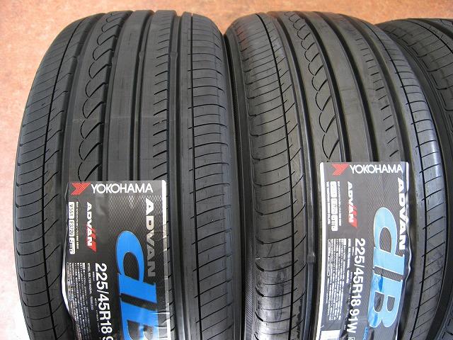

                      I think if you want quiet tyres, go for Advan dB, but i don't think these tyres are designed to be driven on aggressively though.
