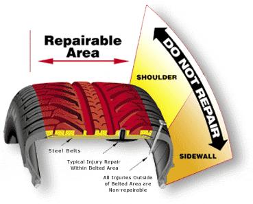

    Kmart Auto & Tyres says the puncture is in a place that can't be repaired. However, when I looked at where the puncture is, it's about an inch from the edge. Hmmmm... anyway, the dude says it can't sealed and they've made it illegal to use an old method of plugs.
    Thoughts???? The wear is light (I've only done about 10kms) so I don't really want to replace it. My girlfriend took her car there and they said the same thing ("puncture is in a place that can't be repaired").

        Depends on who you ask my brother put his Subaru in for a service and was told there was a screw in one tyre which could not be repaired due to it being close to the edge of the tyre, But the said they could sell him the same tyre for half price as quite often new buyers dont want the standard tyres on the Subaru,any way he took the casing to a large tyre retailer who repaired it with out question.

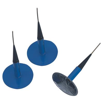

          Apparently they don't use the "insert from outside" dog turds anymore. You can still buy them yourself though.
          They still use the "insert from inside with glue" rubber mushrooms but it's preferable that the base isn't subject to flex.
          I'd seek a second opinion. A lot of the places are very conservative now & seem to prefer to sell a new tyre rather than risk a repair for $20 income.

                  For a proper internal mushroom plug - $25 is top dollar.
                  External (dog turd) repairs take <5mins & should be about $10. $15 tops. There's a guy near Liverpool my mate goes to & if you bought the tyres off him & the tyre/rim is already off the car, he does them for free & fits it back onto the hub for you.
                  The whole kit can be had on eBay, SCA or Bushranger products for $20 or less

                      The good thing about doing an internal repair is that you can inspect the insides for any other damage due to being run while flat or if a 4" nail has gone in through the tread area and looks OK but has started to gouge into the sidewall.

                        Mine was a remove the tyre off the rim job and internal mushroom plug. About $22 from memory. Every tyre shop is going to charge different from one to another.
