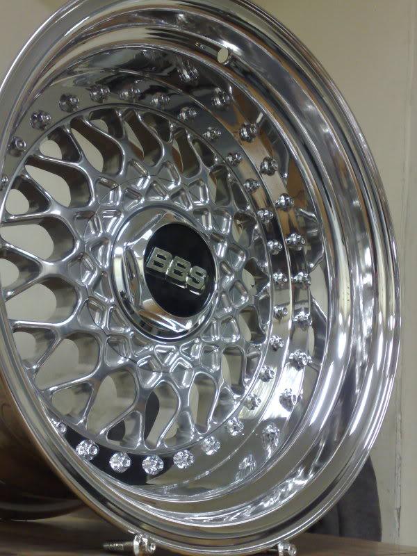

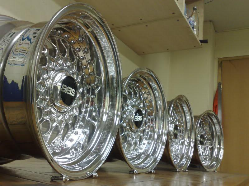

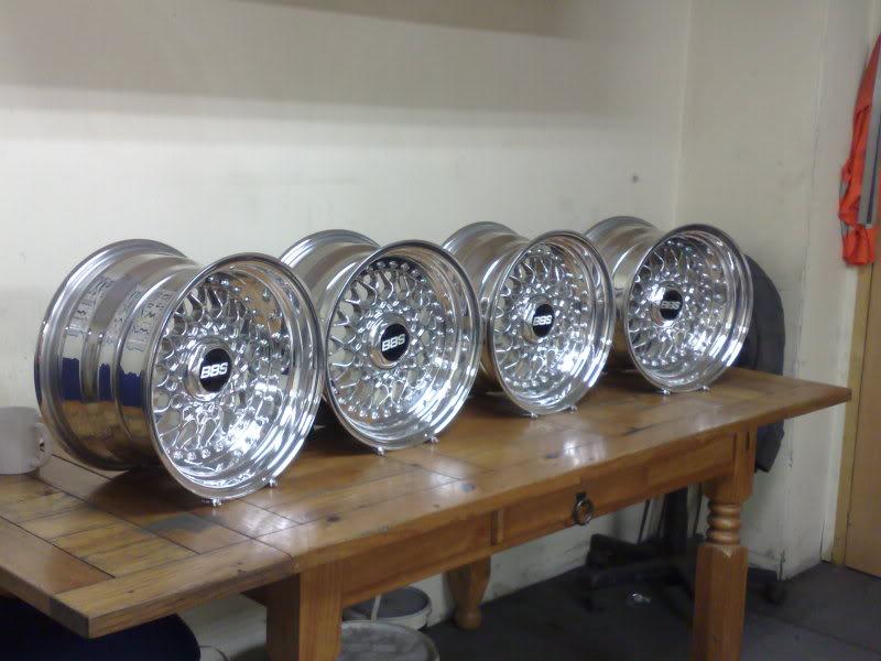

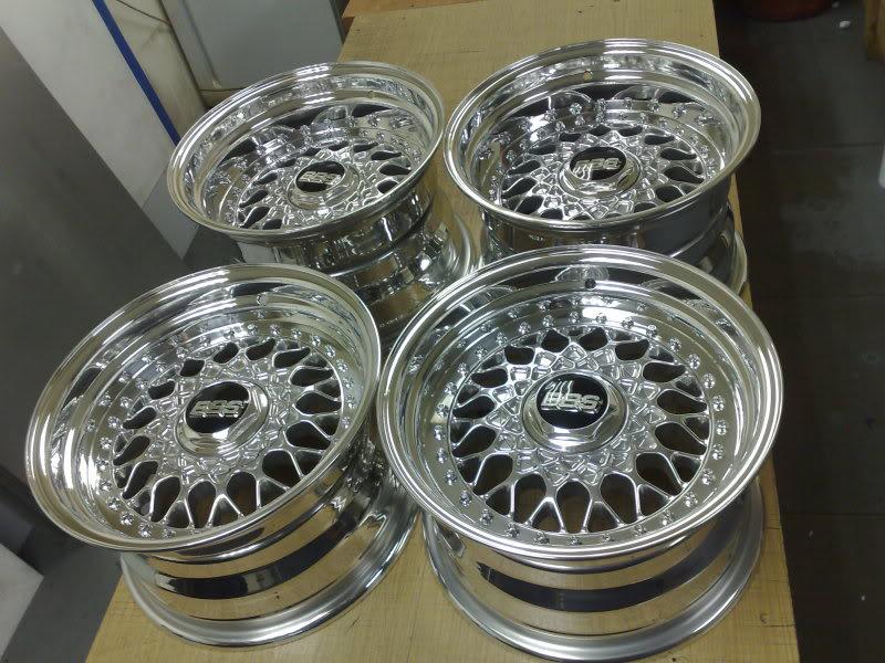

Just finished these and was pretty chuffed with them,thought id share

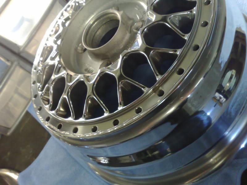

Been waiting on a set of 14" RS centres being returned from canada(long story,guy wanted his polished,we split a set,polished the centres,sent them over and waited on him splitting his and returning them)waited on lips coming from Image which they hucked up but we finally got all the bits back and started work. Ceramic'd the weaves as per,mike polished the barrels and faces of the lips back when they got split/delivered

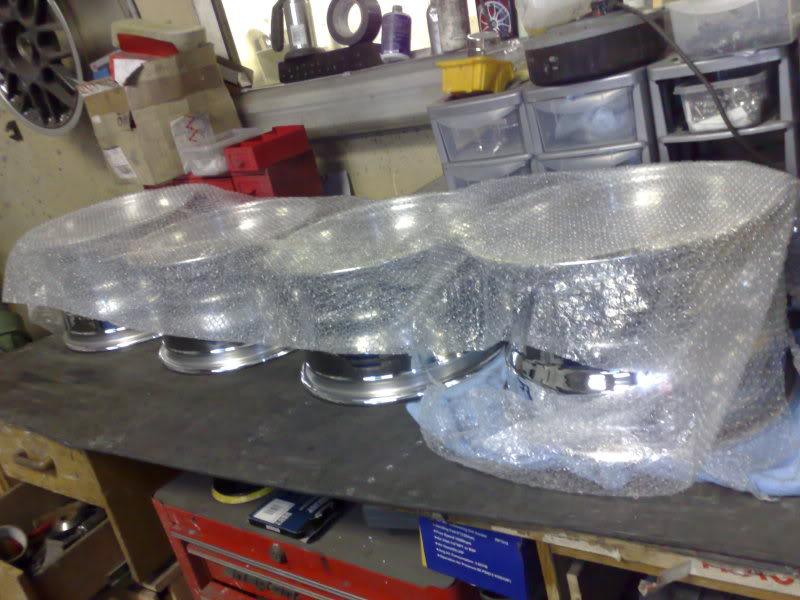

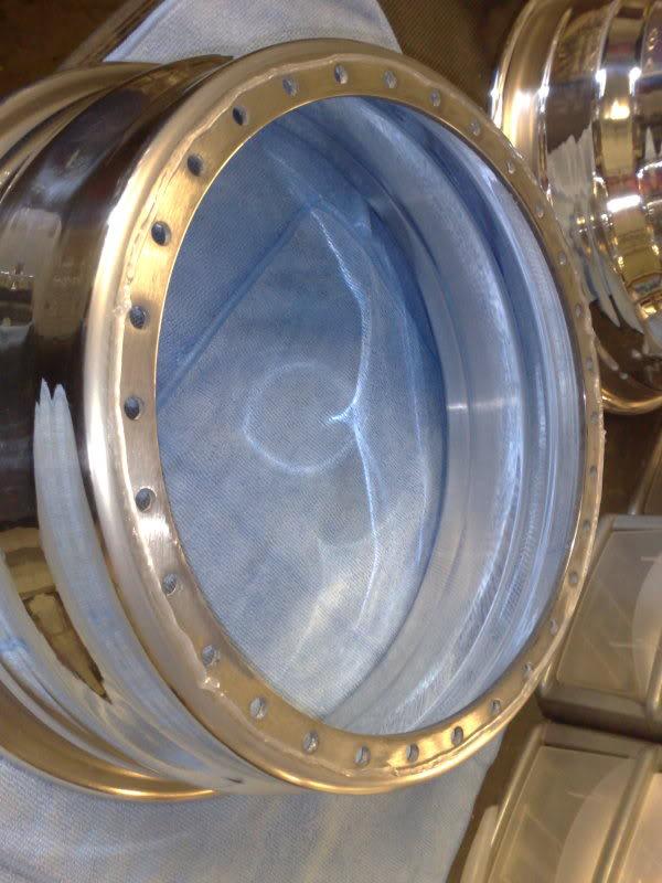

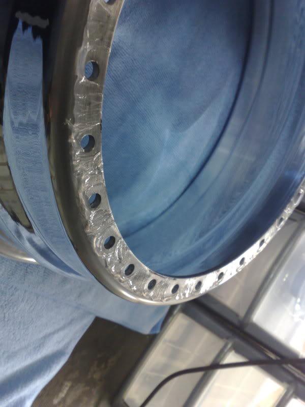

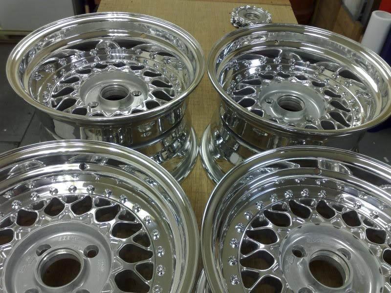

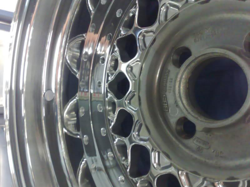

Fast forward to the other day ........... I cut them out the wrapping and gave them a once over and they were pretty marked up and/or still raw finish in areas like the complete reverse off the lip here

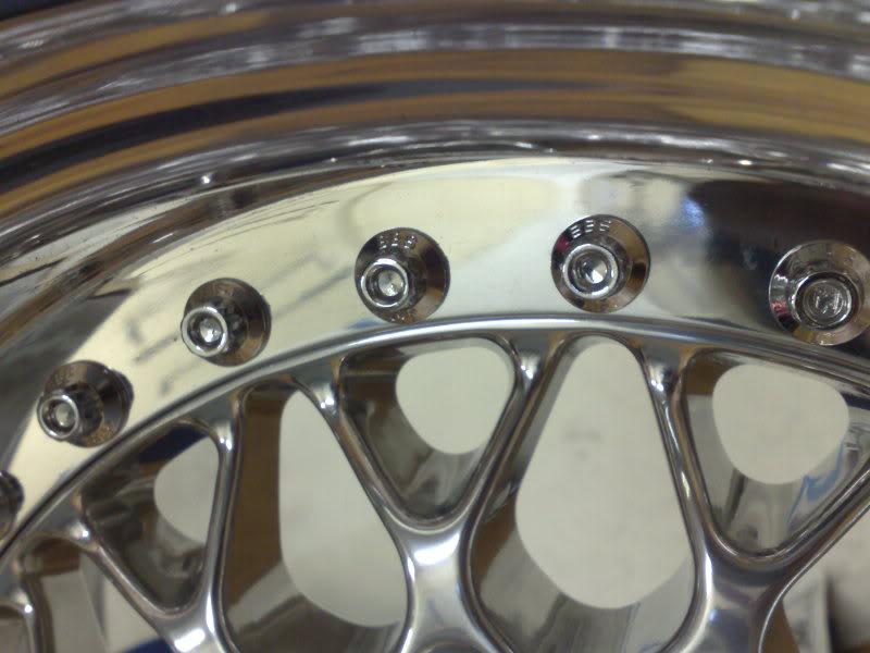

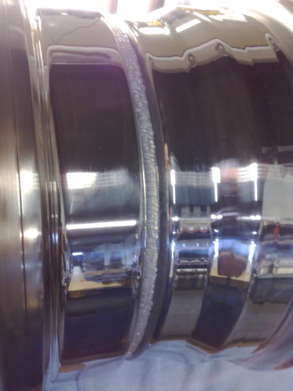

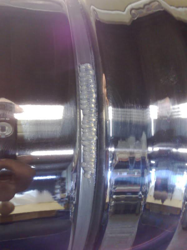

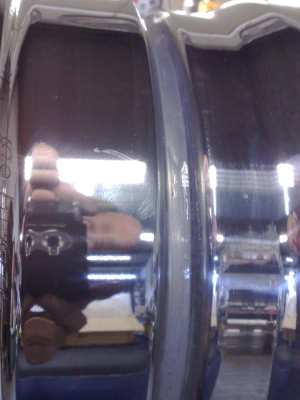

following from playing with polishing and satin'd finishes on the trophies and with one of the previous fully polished sets struggling to get a solid seal on the beads I decided to satin the bead areas after id polished the reverse

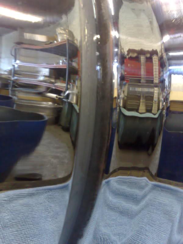

went over them with some hoch to remove handlin marks and polish remnants

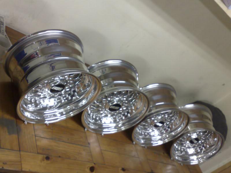

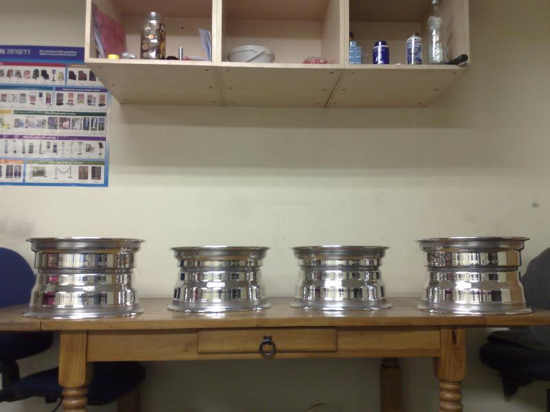

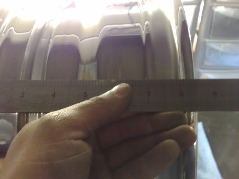

3 1/2"x14"

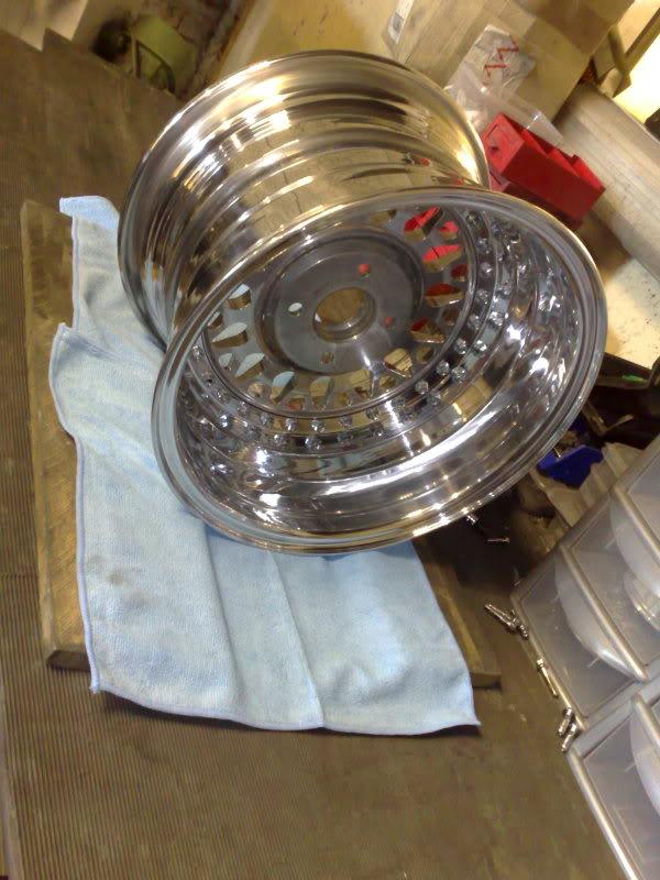

couple trial shots

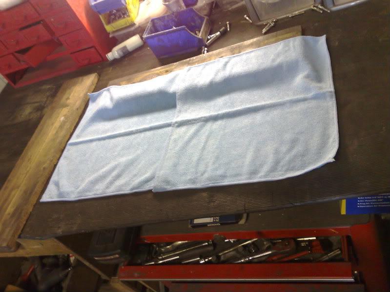

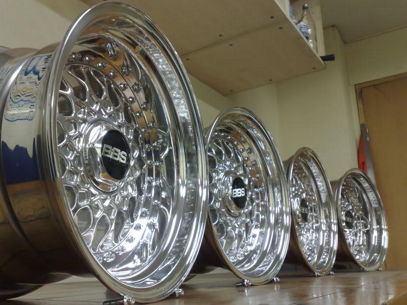

getting through prepping the parts
all set up ready to get stuck together
