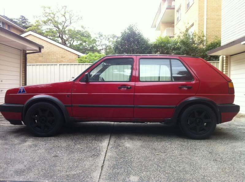

                              • #60
                                Before:
                                After:
