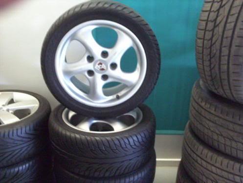

    Hi all,
    Have found some Porsche wheels for sale near by that im keen on, the owner said the specs are 17x7 ET55 and 17x8.5 ET50
    They are apparently off a Porsche Boxer
    they say the tyres are 255/40 r17 and 215/50 r17 so i guess that could be correct...
    Just wondering if anyone can confirm this? I thought porsche would have run something a little wider... (which is what i was hoping for)
    If people think this is the case, what would they be worth?
    Cheers

    those wheels are perfect for adaptors, im actually trying a set on the passat today, except their 17x7.5 and 17x9 all ET53 so well c what happens..
    but yeah id deffo look into those badboys! great starting point
    dom
      tyres will be a little tall?? and as dom said with et 50 you can have space for 25mm+ odd spacers bring your et to a nicer poke friendly number
      Originally posted by Preen59
        Those specs would be correct - 996/Boxster
        Some people opt for two pairs of the rear wheels
        Present: Mk3 Golf variant.
          cheers guys, tyres heights are ok actually, only a little bit bigger then my stock 15s.
          will look chunky but oh well. the 255 will be a little wide but if i can get them cheap ill get them for something better then the 15s to drive on while i pull the BBS apart
          there more the specs i was after dom! if you want them gone cheap... lol
          Not a bad idea ray! dont know if i can get my coils low enough on 8.5s up front though... will look into it!
          Thanks!
