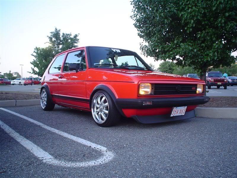

                Couldn't find any pics of any on a Mk2. Only minilites/superlites.
                On a Mk1 tho...
