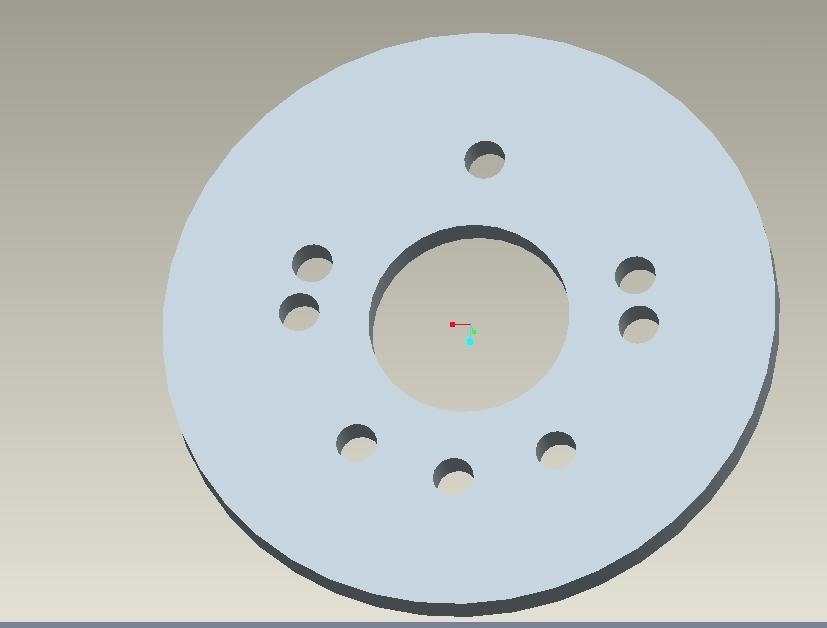

    if you have some 5x100 PCD wheels and you wanted to make them 4x100, could you get them drilled to suit and it still be safe? (i know, im the mechanical engineer but i have other assignments to do - might as well see if anyones done it first). assuming the hubs are solid alloy and quite beefy.
    i've heard tell of someone doing this kind of thing...
    i've also seen a gemini with 5x114 wheels drilled to 4x100 - but in that case the PCD is different. in my case, you can have a common hole, but 2 sets of holes seem to be pretty close to eachother.

    The top and bottom holes in your picture have plenty of land around them. I vote you just drill them and get busy. Make sure the countersink is done to suit the stud you plan to use. VW ones are curved not straight.
      Thats a good diagram. 3 out of 5 should hold em on anyway
