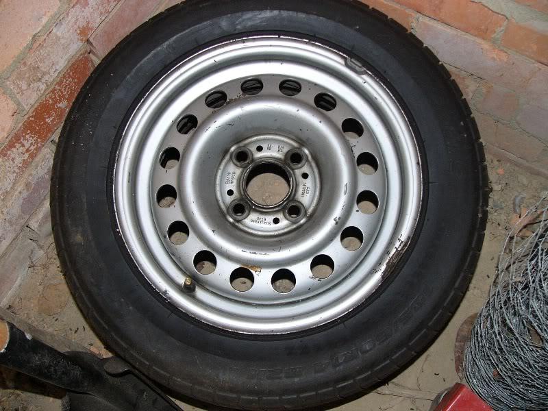

          I just picked up a set of 16x6.5" 4x100 ET35 60mm CB Renault Megane steelies, will look great once theyre wider

            BMW E30 Steelies.
