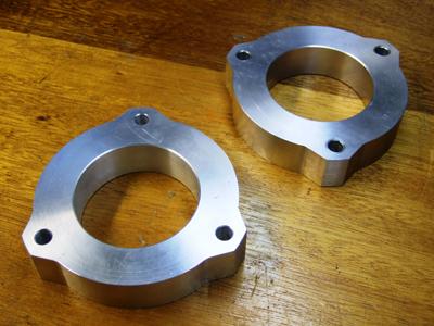

    I have found a guy in South Africa that has made his own Coil Strut Spacers that would be perfect, except for the fact that installing them is quite a job and once in they’ll pretty much have to stay in. They are similar to these ones: http://www.snakeracing.com.au/coilstruts.html
    But his look like this:
    The obvious advantage of this solution is that it achieves the best lift, is robust and reliable, and doesn’t place the socks and coils under any extra stress. Of course, it’s not something you whip in and out on a whim though, and it could cause added wear on the CV’s etc.

    What if you got some of option A made up but they were hinged in the y-plane and able to be torqued around the top of your strut? IE, jack up, give clearance, fit and torque, drop? Similar in principle to head stops on hyrdraulic cylinders in large machinery...

      RE spacers:
      Not a good idea. You have to be super carefull they are installed correctly for a start. The other issue is you are changing the dynamics of your shocks and struts which can cause erratic ride. These will most likely result in a maximum lift of 8-10mm due to sag after they settle in, plus they are only for the Cruiser and Patrol so far.
      Unfortunately if you are after off road clearance, I can only suggest a larger diameter tyre to keep the original dynamics as intact as possible but the tig was never designed as an off-road vehicle. Dirt tracks are about the limit of what it's suspension is designed for.
