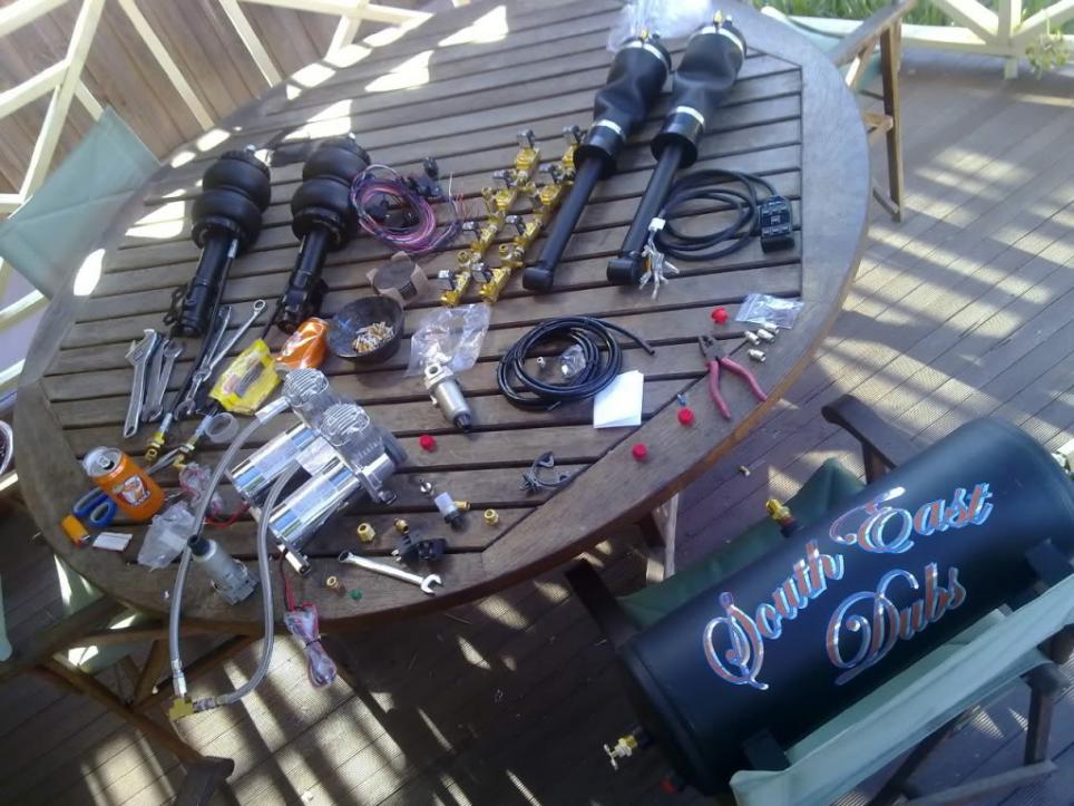

    righto, this is my build thread on the whole car, but ill do a specific build thread on installing air ride
    make sure you have everything there! and mock up everything before you fit everything together!!, things like, compressor, tank, air bags, switchbox, wiring, guages, and various fittings to put it all together, all of that stuff should come with the kit though, SHOULD!! lol

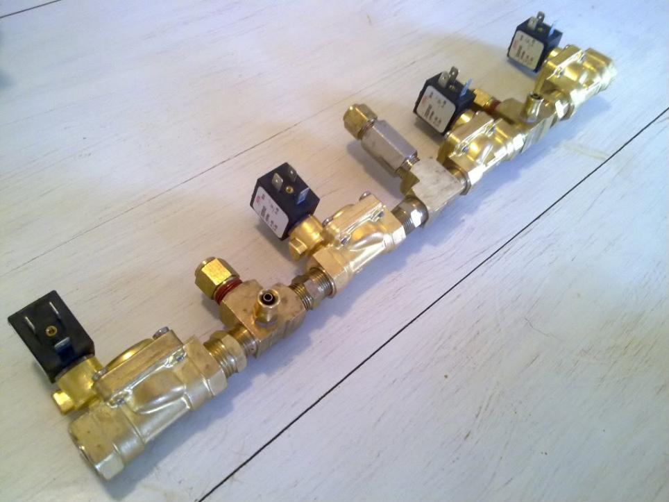

    ill talk everyone through the valves that are temp built
    ok, starting from left to right:
    this is 1 row of valves, they could control either front or rear of the car, 2 valves per wheel, the outer valves, far left-far right and dump valves, the control the air out from each bag, in the middle you have a big T fitting, that is connected to the air tank with some hose, the air is pumped into that T fitting and then pushed into the 2 middle valves. they control air INTO the air bags, that air then gets pushed into the little nipples you see in between the IN and OUT valves, a hose is connected to that nipple and to the airbag's, also take note of the little 90deg nipples facing the camera, they are 1/4" fittings and are connected to the gauges and give me a air pressure reading inside the car. now.... all this is controlled by the black boxes on top of the valves, the wiring loom gets plugged into the valves, then plugged into the color matched switch-box wires, hence! power to control the valves going up and down! YAY!
    now the valves are done, what ever fitting are left, mix and match to complete the rest of the stuff to have a complete kit.

      Nice write-up, the valve set-up is easy enough to understand!
