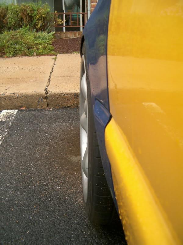

          This is 15x7 ET20 front (ET24 will sit 4mm in):

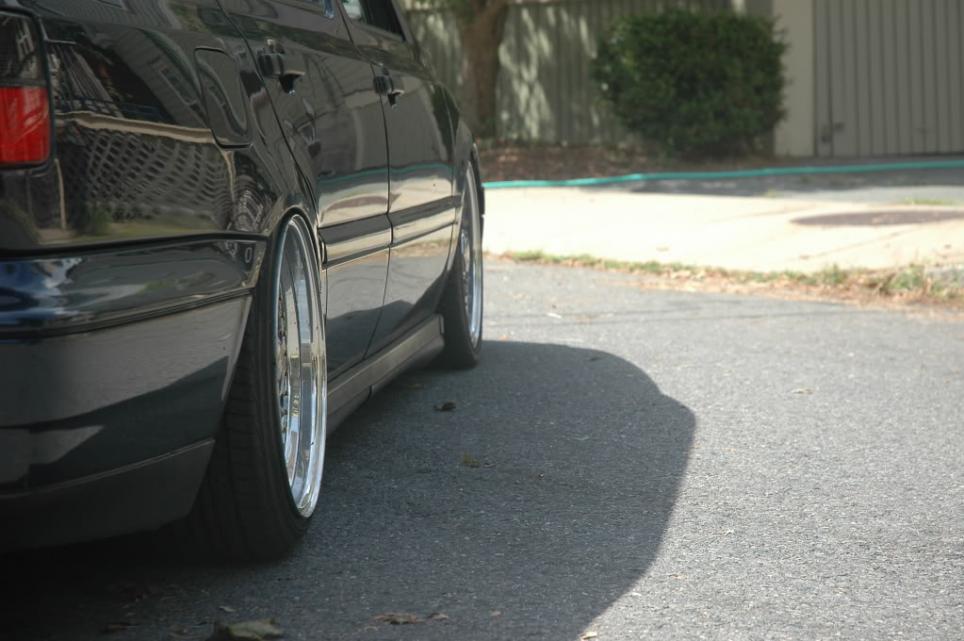

          And this is 16x8 ET20 rear (again, ET24 will be 4mm in):
          So yeah, perfect offsets to start with Once you've come to the realisation you need more rubber stretching and scrubbing in your life, add 10mm spacers or buy +0.5" lips and you're golden!
