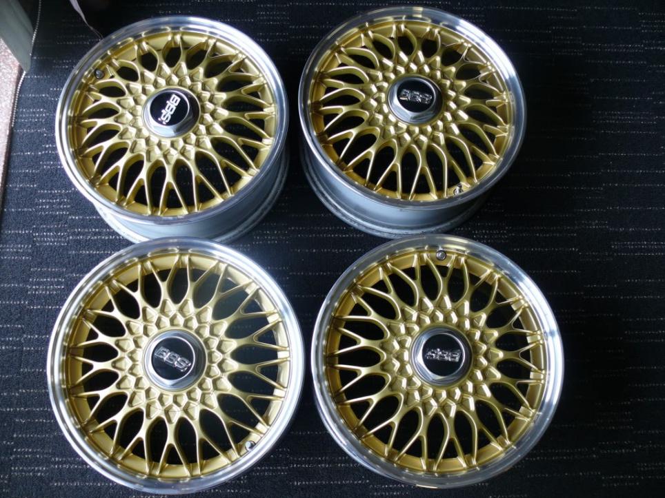

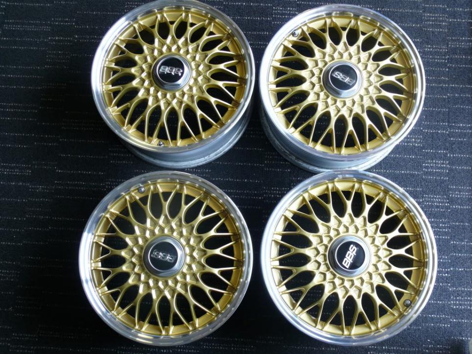

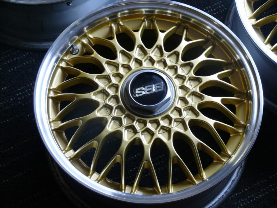

                      this is how they look now

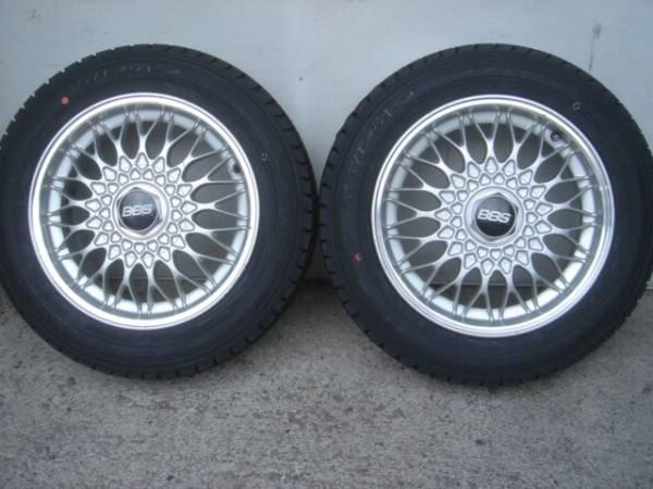

                        That looks FANTASTIC Mick! I hope you're gonna go with some nice low-profile tyres too - the first pics when they were silver and with the balloon tyres look horrible, but what a change!
                        By the way, where did you find that gold colour?
                        Present: Mk3 Golf variant.
                          the colour is wrx gold with 10% silver.low profile tyres is a must! and those balloon tyres were with the wheels when i bought them.the pictures i took are really bad. they look better in real life.
                            Now you have converted these wheels to 5x100, don't you think they would look good on my Polo?
                            I'm not asking for charity, you can have my VW Siatas....
                              Wow they've come up tops!! Nice work mate, looking forward to seeing them on the VR
