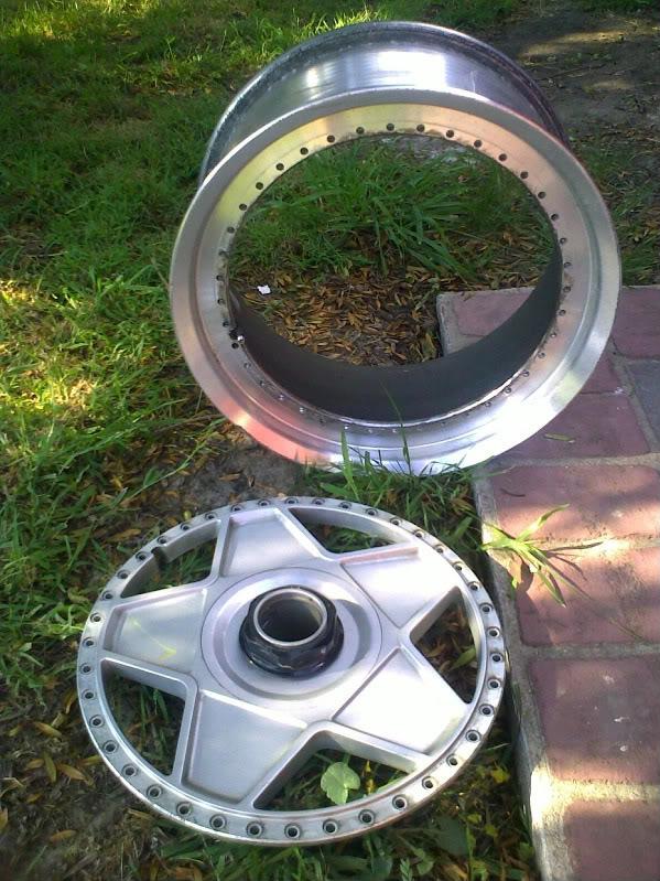

    these have been sitting in my garage for almost a year now, holding them for a friend who doesnt live in victoria, anyways, i always loved them so i put an offer to take them off his hands, he accepted and here you are...
    they are Auto strada, modena's made by work wheels, rare as fuk!
    the specs are 17x7.5 and 8 rears ET50 and 52 PCD 5x114.3
    plans are to machine the lips (gutter bashed aint the word!)
    repaint the centers silver
    drill another set of PCD to 4x100 so all 4 bolt vw and mk5's can use them with wobble bolts
    some pics
    now half split

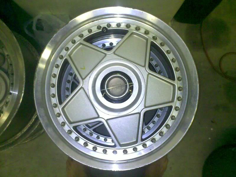

                    ive hit my first speedbump, the PCD overlaps the new holes ill be drilling, so that means ill have to weldup the holes and redrill a fresh new set, im spewin in a way for the 5x112 blokes who can run wobble bolts, but screw em hahhahaha!
                    some pics, the hole overlaps like 2mm on 2 holes OR 1/3rd of 1 hole
                    and ive marked out the the existing holes are and if they are close to the new holes, the black dots show the the PCD overlapping 1 hole, and the silver dots show the 2 overlapping holes
                    looks like ive got plenty of meat for the other new holes

                        Don't weld them just insert them. You don't want to have to weld them and then stress relieve them. That's just a PITA.
