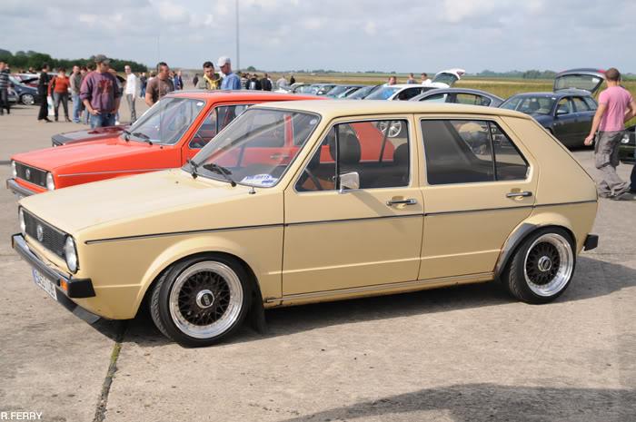

    forgive my laziness please but I am still working out how to determine offset and I wonder if anyone would comment as to wether these will fit my MK1. I will not be lowering the car at this stage but I am wondering what would happen if I lowered it mildly say 15mm. Pls forgive my learning curve on this subject I have always bought mags second hand and simply fitted them to the vehicle, the lack of choice in this area means I will probably have to order my rims.

    Good size and offset I think.
    No bigger than 15s on a Mk1 and 38 offset should be fine.
    There are heaps of second hand Jap wheels on ebay in 4x100, just have to keep a look out.
      Always been a fan of the sportmaxx's I wanted to get a set for my old GL but instead got smart and bought a VR6
      Lots of people on www.vwvortex.com running these, run a search to get some inspiration.
        black matches beige
        black seems to match well with beige
        Don't say a word about me painting it the same color I may get lazy
