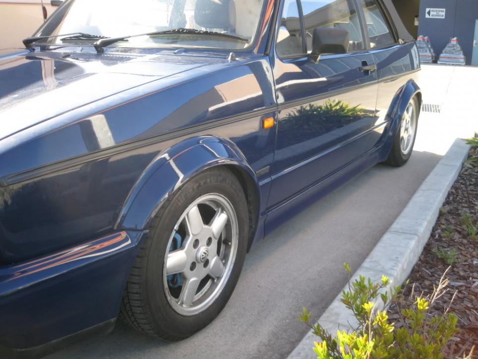

              Mine is a daily driver and is as low as seems safe without ripping the backside out of it, running stock rims and standard profile tyres. I love it like this
              Doesn't it look nice being low!
              1993 MK1 CAB ! Work in Progress........
