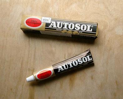

      As the title says. In my young days when I used to race pushbikes I polished all of the Campagnolo gear with Solvol Autosol. Is it still available? Used to do a bloody fine job
        Yes, but I think you've got the brand name wrong.
        This is only good for wheels without a clear coat. I used to use it all of the time.

                I have some Autosol in the shed, you still buy it in the UK. Bound to be something like it downunder.
                Gavin
                  I was given some autosol for christmas, so it's available somewhere

                    they sell it in coles down here.
                    well if this is the stuff we are talkin about

                      The right stuff
                      Yep. Thanks mate. I'm off to Coles

                      I masked up and painted the centre parts with Satin Black and then used very fine wet and dry to remove oxidation from the exposed alloy parts. I then rubbed back with cutting compound but couldn't get the final "polished aluminum" look. I reckon the Autosol will give me that.
                        get yourself a range of wet and dry starting from 320 to 800 is with one step in between. when you fingers are sore and bloody you may be close, next go to the hardware store and get a polishing mop to suit your drill, if you have a bench grinder thats even better(but more expensive to set up) then starting with the brown compound and a rough mop go to town with that finishing of with a cotton mop and white compound and then use the autosol to maintain the shine(although i prefer the softer less abrasive polishes ie mequirs and mothers)
