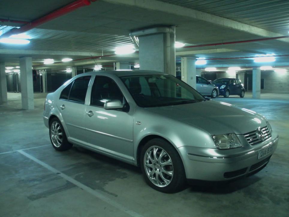

    So anyways, I fitted the Momo's to my bora and they look good but took it for a test drive and they had been balanced by the tyre shop for my car but than I had a vibration when coming off of power. Went through what I had missed and realised the centre bore was much bigger than my car's. The momo's are 77 and I think the bora's are 57. So quite a big difference, where can I get spigot's or hub centric rings ? I don't imagine it would be safe to drive on so I'll have to put the stockies back on for now, unless I take it straight to a tyre shop monday morning...??

    ring around a few tyre shops, they should be able to fix you up.
      I had MOMOs on my last car and they came with hub locating rings that sit inside the centre bore. They were about $20, so you should be right. If the dealer camt help, call Roman Autotek here in syd, they used to the MOMO distributors.

        Thanks will see what I come up with.

          Got them ON
