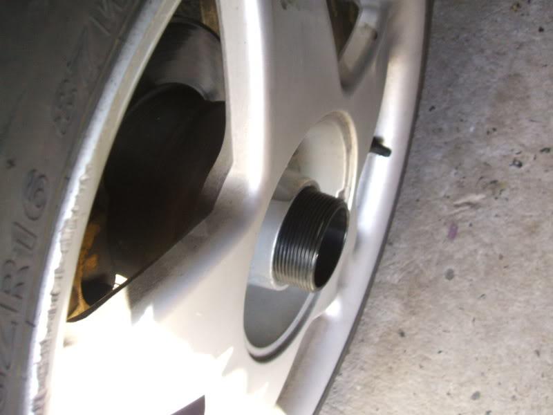

the old c'caps used a threaded part to screw into a threaded section of the speedlines hub. the threaded section is only about 10mm long and goes in from the outer end of the hub.
thanks to SAE standards, this thread is a 2" pipe thread, which also happens to be standard for HDPE agricultural piping...

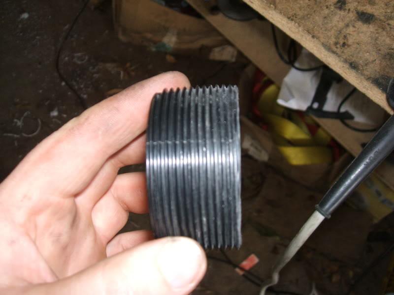

now, it also happens that bunnings sells a 2" water tank pipe coupler, which has some nice big moulded bits on it that seemd to fit my purpose, and enough 2" plastic thread to suit my needs:

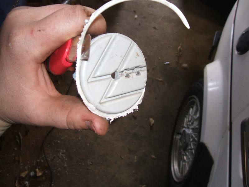

now to the steelies centrecaps - take to them with a 50mm hole-saw and arbour. because of who we are, we want to keep the vw logo in the middle:

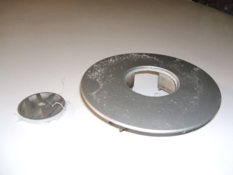

trim the swarf off with a sharp knife:

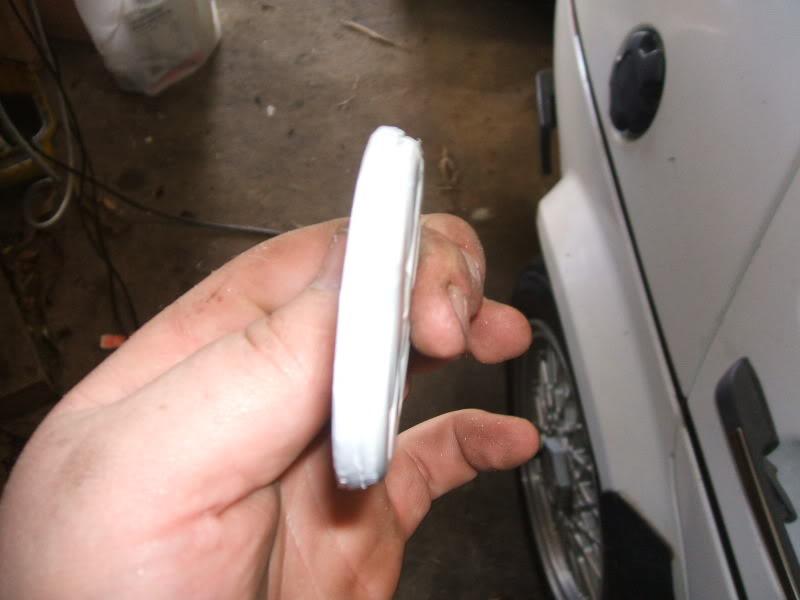

then use a grinder and flap-disk, or similar implement, to sand the outer edge of our badge to a taper, like so:

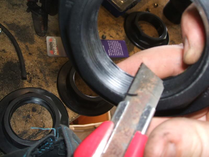

now take the nice moulded plastci nut, and cut at an angle, the inner threads out, so as to accept our badge:

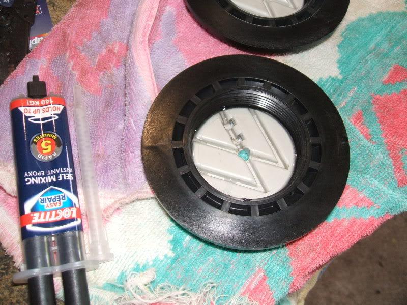

using some quick set epoxy (i've used loctite epoxy in the ready to go syringe type applicator) glue the badges into the caps:

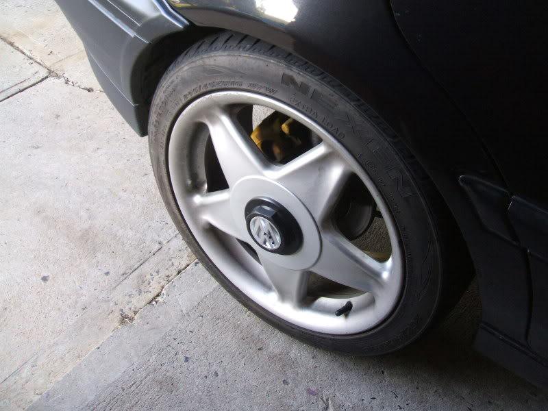

now, all thats left is to screw the threaded pipe into the wheel hub, and make sure its firm. then, push the bored out cap into the wheel, over the thread, and finally, screw the completed cap center onto the thread, holding the whole assembly in place -
for anyone who has threaded center-caps, i'm sure you'd be able to work out something similar if you feel so inclined
