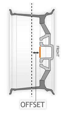

    Im really confused about all these offsets (positive and negative) and all that stuff that goes with wheels, can someone please enlighten me as to how all it works..
    Cheers

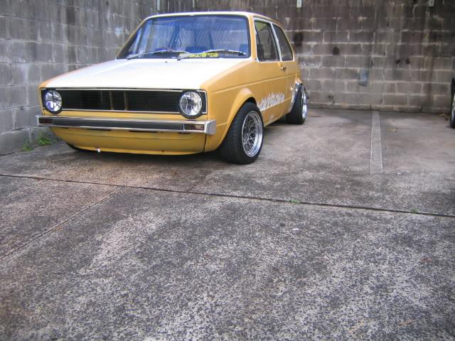

    Higher the positive number the more the wheel sits in the arch. The lower the number the more the wheel sticks out. If the mounting face is very low (negative 6mm) this happens
