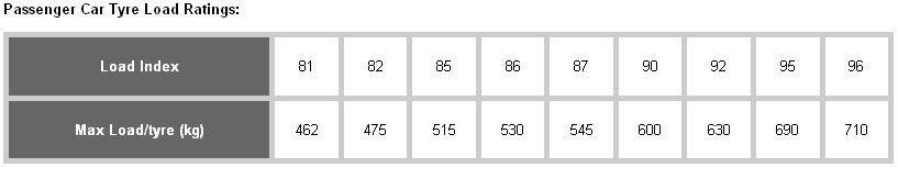

      Another piece of the puzzle, Load ratings are the number that preceeds the speed rating eg 82H
                      Anybody know the Max load per tyre for Load Indices 99 & 103? (please...)
                      EDIT: 99 = 775kg/tyre, 103 = 875kg/tyre.
