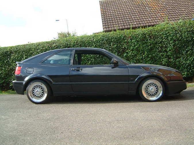

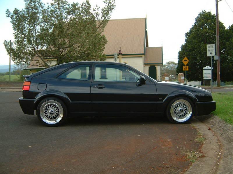

                  Hi Steve, i've got 195/40/17 all round on my 17" RS, they are 7.5" front and 8" rear.

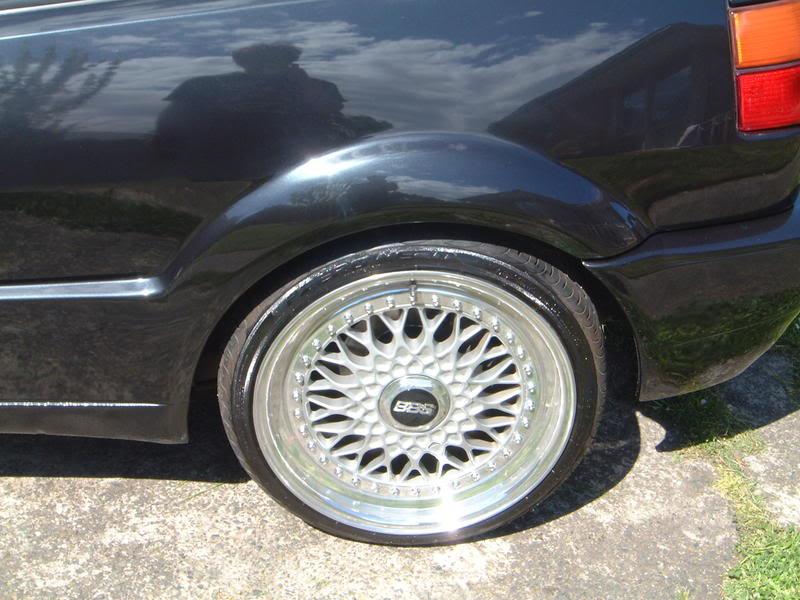

                  I had 195/40/16 on my 16" x 7" RS when i had the car shipped over here, then i split a tyre and couldn't find that size anywhere, they were Conti Sport Contact 2's.
                  So i had to get a new set of 195/45/16, it was a noticable difference in over all diameter, it made the arch to tyre gap smaller and raised the car up a bit, the ride felt a little smoother in a straight line but turning into corners was completely different, more flex in the 195/45's.
                  If i were you i'd go 195/45 all round, looks wise you'll have to lower it till it touches the ground to get it to look right from arch to tyre with the 195/40's. The Golf 3 and Corrado have such big arches you need to fill them out IMO. This is why i went to 17's, so i could run 195/40 without losing overall diameter.

                      195/40/16
                      195/45/16
                      195/40/17
                      195/40/17 on 7.5"
                      195/40/17 on 8"
