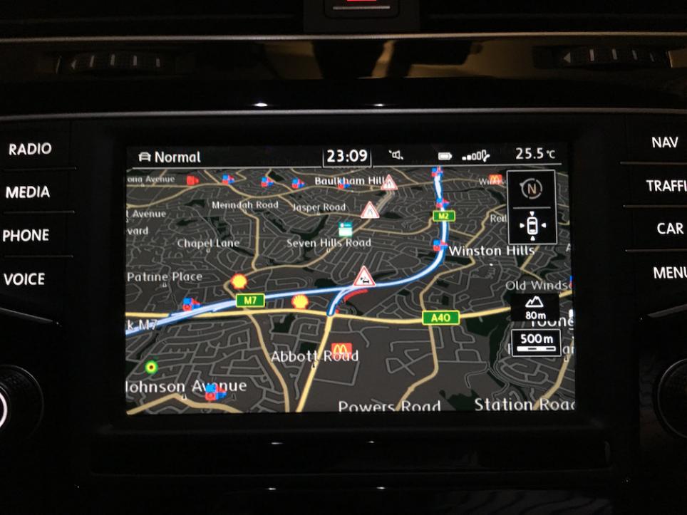

    Just tried it on my MY16 golf highline, works. Thanks

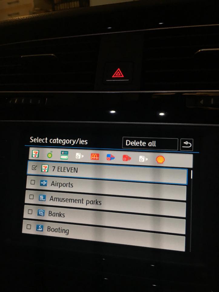

      How do I select which POIs show up by default?

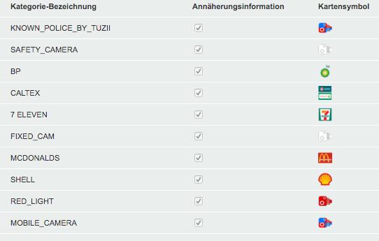

          The tone is built into the zip file. Its selected during the creation process. I am not aware of anyway to individually disable it for each poi except during the creation process. This doesn't mean that there isn't one though.
          EDIT: Here is a link on how to do it, it includes a link so you can choose your own poi's and make your own files. Its extremely easy. You can add mulitple POI files into the creation process.
          MIB II - Custom POI's / Speed Cameras etc
