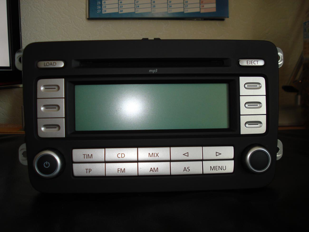

Currently have a Silver buttoned mp3-cd compatible RCD500 ( http://www.golfmkv.com/forums/attach...1&d=1253359162 ) with a CD emulator kit like this( http://www.ebay.com.au/itm/Bluetooth...item2ecb164409 ) that gives me AUX USB & Bluetooth connectivity.
It works, most of the time, and is fairly limited in its integration with the rest of the car. Eg It will read music off a USB if the mp3's are sorted into folders like "CD1" "CD2" etc. However because the unit emulates normal CD's rather than mp3 cd's i dont get any song info apart from "track01".
Bluetooth streaming and calls works great, save for the fact that there is now way to play/pause skip tracks etc without physically interacting with your phone while driving (illegal hear in australia). and aux is aux with the input being a little poorer quality than i would have liked.
That said for the amount of money i shelled out (around $80 Australian) its served me well.
