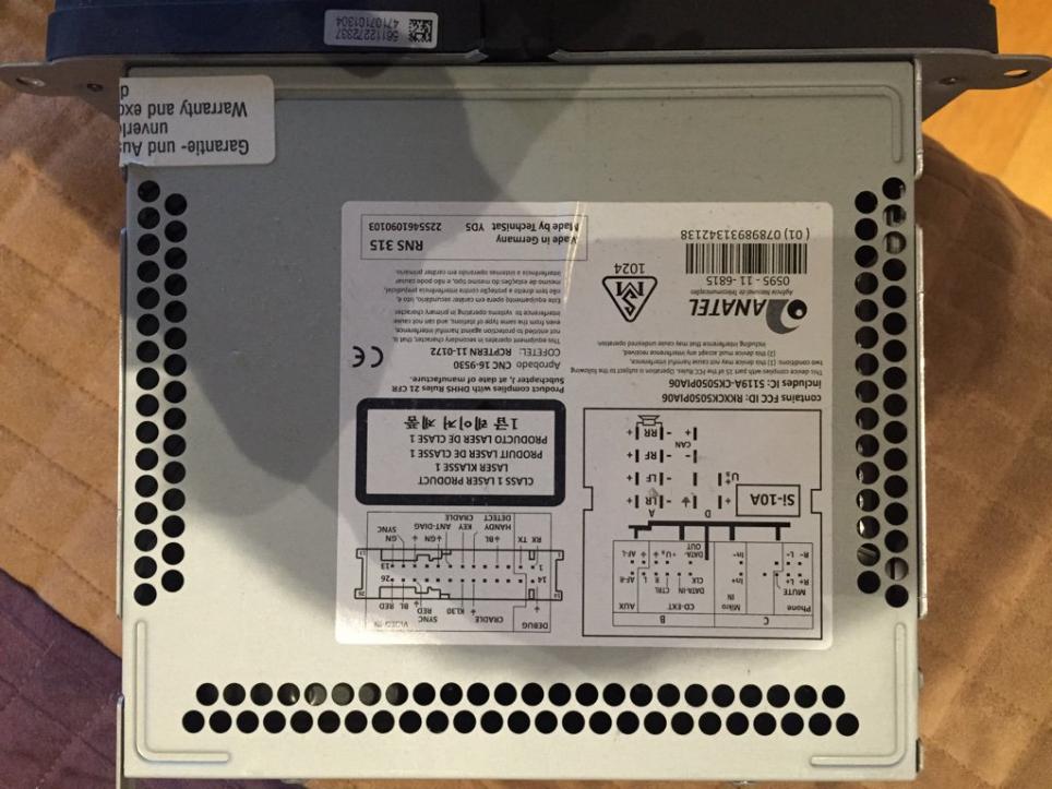

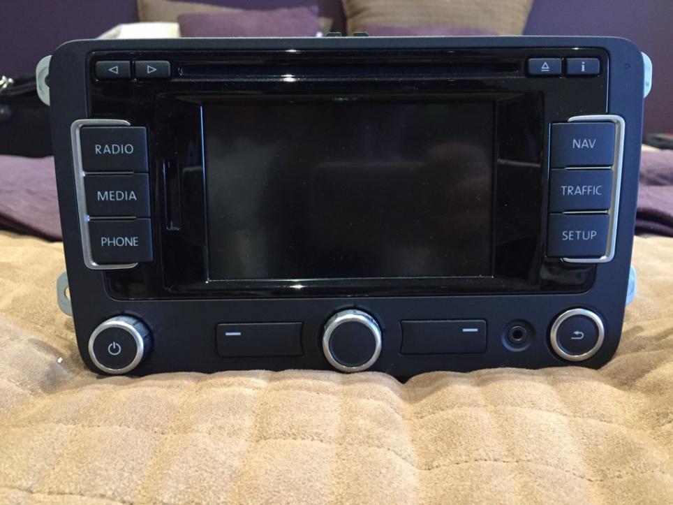

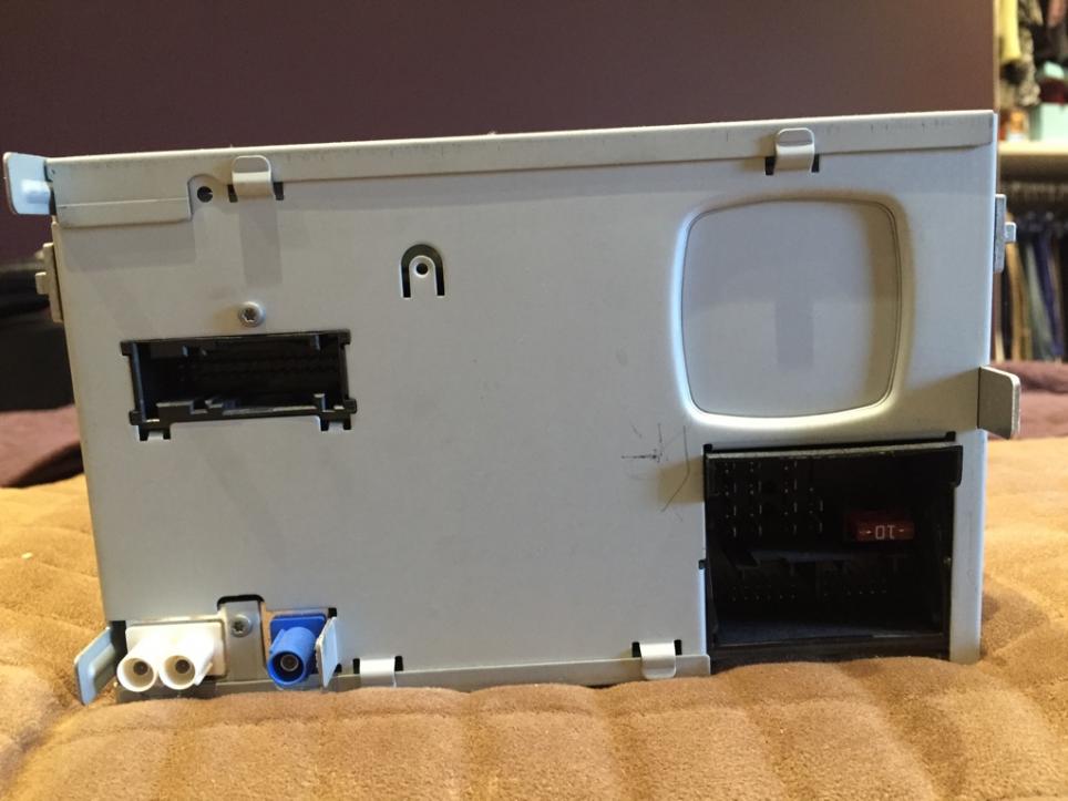

      Hey, sorry it's taken me a while to reply!
      I've attached a couple of photos of the unit if that helps at all
        Is the canbus gateway something that is a direct swap over? Or will there be some sort of coding involved?
        Cheers!
          Yes thats a RNS315. Gateways do require recoding
