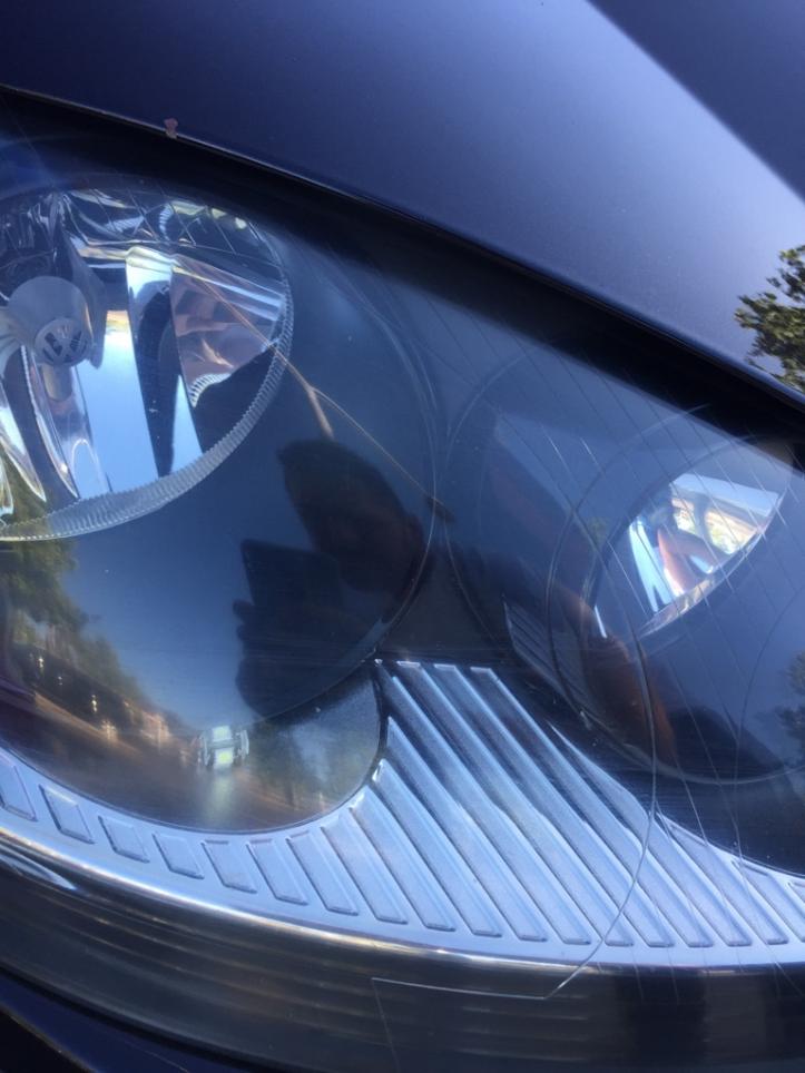

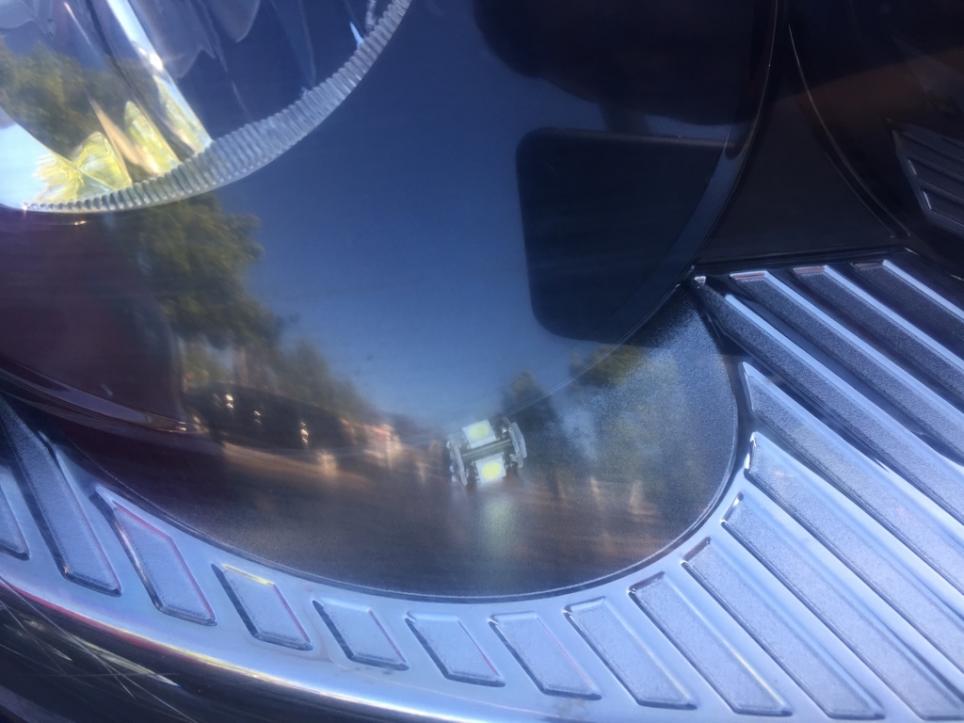

          So I thought that it blew, I had a look today and this is what I found.
          The LED parker snapped in half and fell into the headlight.
          Now how do I get it out? Lol
          GOLF 6 R - APR stage 1
            Yep, that'l do it...cheap LED? Maybe poke a cable tie with a bit of chewy or something sticky on the end to catch it after removing the main globe to get in there easier?
