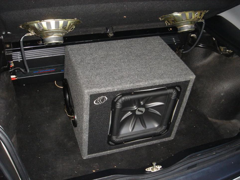

    THAT SUB BOX IS HORRIBLE!!!!!
    It does not do the L7 any justice!! A 12" JL with half the power in a JL box is louder and deeper then that L7 in that box.
    If you are happy with it, thats fine, but if you want to get what you paid for then look in to a better box.

      Perhaps you should read the specs on the Kicker solo's before you judge. Dude JL subs don't get loud.. period ( with the exception of the W6 and W7 with 1+kw ).

        I have read the specs..... and they dont mean anything unless you know what to look for and the science behind it, as well as talking to some people with experience and having some practical to back it up. If i havnt seen it or i dont fully understand it im guna keep my mouth shut.
        90% of your bass comes from what enclosure you have. Better box = better bass. I have hooked up a JL sub (~400rms rating) in there standard box then played the same song on the same amp (kicker 750.1) on the L7 in there standard box and the JL bass was better due to a slot port. Im not blindly judging. The L7 box is just not good and could be alot better to accomodate the 750+rms. I have talked to some pro's who have masive amounts of experience in the field, as i was interested in a L7, they all agreed not to bother with the standard box because its prity rubbish. Not big enough, not tuned well and not ported well.
        Maby you need to brush up on your facts before saying JL subs dont get loud. RMS doesnt always mean more bass. JL W7 vs kicker L7 is a common comparison, like holden and ford.

          Fire up dude, perhaps you should have read the bit in the bracket so ill insert it again Dude JL subs don't get loud.. period ( with the exception of the W6 and W7 with 1+kw ).
          People with lots of experience in the field, sounds like JB to me, there is much more to better SQ and SPL than Kicker and JL. Of course the L7 could sound better in a bigger box but what is the end goal? If that is all the space he has then thats what he need to take advantage of it. Stick that in a 6th order bandbass and of course it will get louder but at the sacrifice of any normal music abilities. Stock boxes serve a purpose, I am not saying they are great but they may serve his needs well. IMO stick it in a sealed box.
          You say off the same amp the JL played the song better but what are you talking about? Was it louder, did it sound better, did it exhibit a different Q?. Also because of the port tune, one may be better suited to the song. Most of the time as I said the stock boxes are very safe in response and power handling. If the JL has the port suited very closely to the Hz of the hit, of course it will seem louder. The are also woofer efficiency plus the efficiency of the enclosure plus the cabin gain of the car plus the phase of the woofer due to positioning etc etc all play a part.
          I like how you say RMS doesn't mean everything... thank you captian obvious. As you said commonly campared like holden and ford.. well as like them, there are a lot better value for money and higher quality products out there.

            Guys guys, it's ok! I assumed the box wouldn't be the best I could get! I had this same concept in mind when purchasing the KS series kickers and not something like the RS or SS...
            Nothing you buy with the product ever will be the best! I couldn't be assed to get a tiny bit more bass into my car...that L7 thumps the **** out of any other sub I've heard in a car. That pleases me. It hurts my ears to turn it up enough, and I can SEE (yes, SEE) that it's still got more in the kick in it if I want to turn it up more. I've gotta be happy with that, what's more power when I've ALREADY got more than enough!?! Lol...

              Yeah thats what I mean, if your happy with it then why change. Its all good for someone to say it's crap but there are other restrictions that they might not know about.
              Leave it as it is and enjoy your music at normal levels without being a tool that wakes everyone up at 1am in the morning.

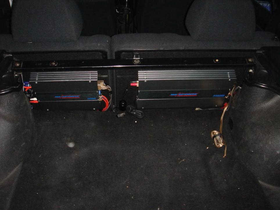

                                Anyways, we had pretty full on day. Not much photos yet but good progess. Should be 1 more day head of us.
                                I belive your previous set up was only testing Right mickey but you kinda just left it there was a few weeks
                                FROM THIS [
                                TO THIS
