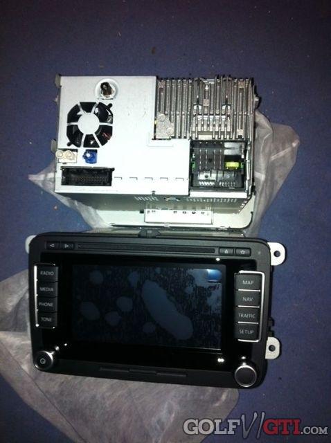

Was searching for something else to help someone and then figured I'd check if any progress had been made on getting digital radio for our RNS510's, and it looks like we're in luck.
Only bad news is that the system needs replacing with a new version that has the black digital antenna connection (up top). I did hear others talk about some other DAB+ adapter that uses the MDI wiring (so the MDI would stop working if you had it) but I haven't seen where the actual product is.

[+] UPDATE 4 JAN 2016
To help new visitors work out which unit they wish to buy, note the following:
Part Numbers:
xxx xxx 680 – Europe / Australia / Russia / Africa
xxx xxx 681 – Japan
xxx xxx 682 – China
xxx xxx 684 – USA / Canada / Mexico
xxx xxx 686 – DAB/DAB+
At present, the following DAB+ models are available:
1T0 035 686 G (1T0035686G) – RNS 510 DAB/DAB+
1T0 035 686 E (1T0035686E) – RNS 510 DAB/DAB+, EU West V10 Maps
1T0 035 686 F (1T0035686F) – RNS 510 DAB/DAB+, EU East V10 Maps
These units also feature:
New GPS chip
40GB SSD Hard Drive
Thanks to my-gti.com for this updated info!
