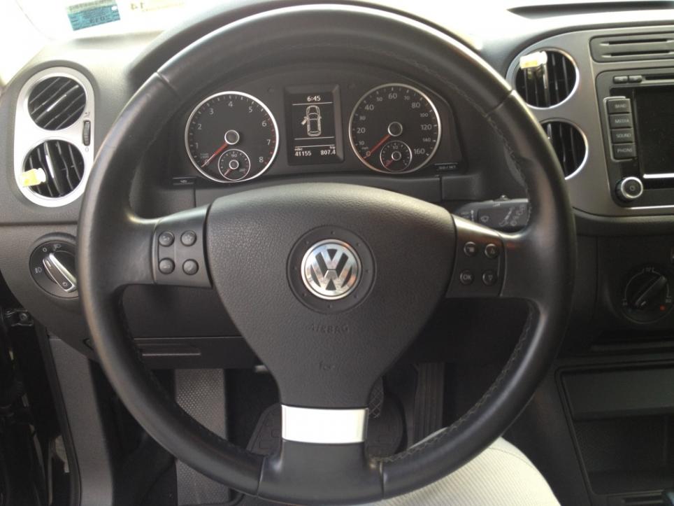

                        Unfortunately I have the old 8 button MFSW, like the one posted below, and it doesn't have a mic button, only phone and star: do you know if it's possible to activate PTT even with this SW?
