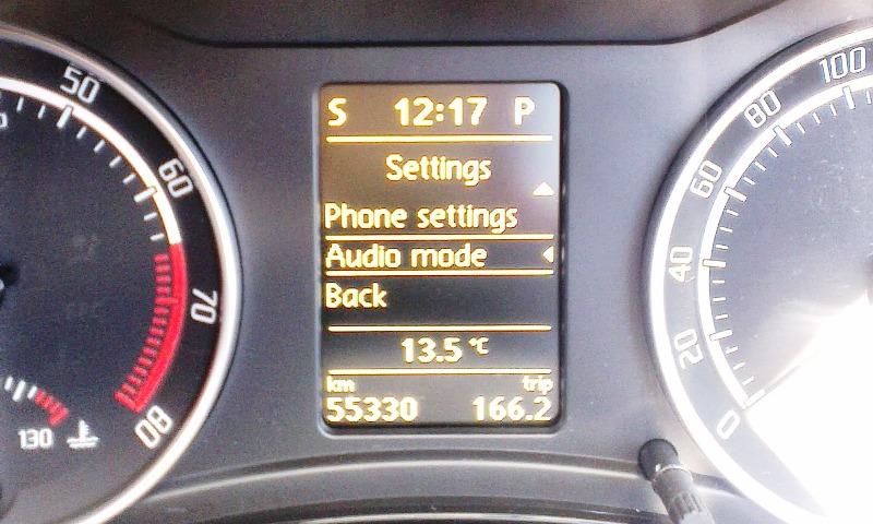

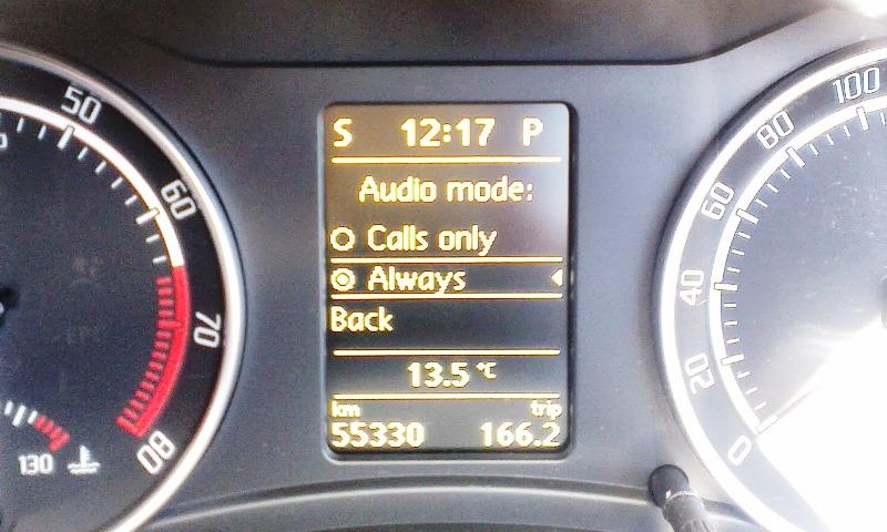

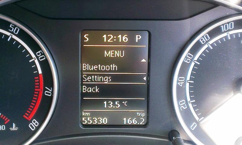

              i have the 9wz, which is basically the 9w7 + rsap, so it should be similar.
              try playing with the phone audio mode settings (under the phone menu) - that may, or may achieve what ur trying to achieve.
              MY17 Superb 162TSI, Business Grey, Tech+Comfort Pack, APR ECU+TCU Stg 1, SLA, Rieger Splitter + Side Skirts, Eibach Pro-Kit Springs, Hardrace Swaybar, TPMS
                Thanks. Unfortunately in my 9w7, under Settings, I have only these two options:
                - Phone book
                - Ring tone
                No option for audio.
                MY18 VW Tiguan Comfortline

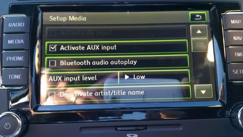

                  Theres a setting in the RNS-510 (I think media) which turns on BT Audio auto play, that might sort it out.
                    that won't do it......
