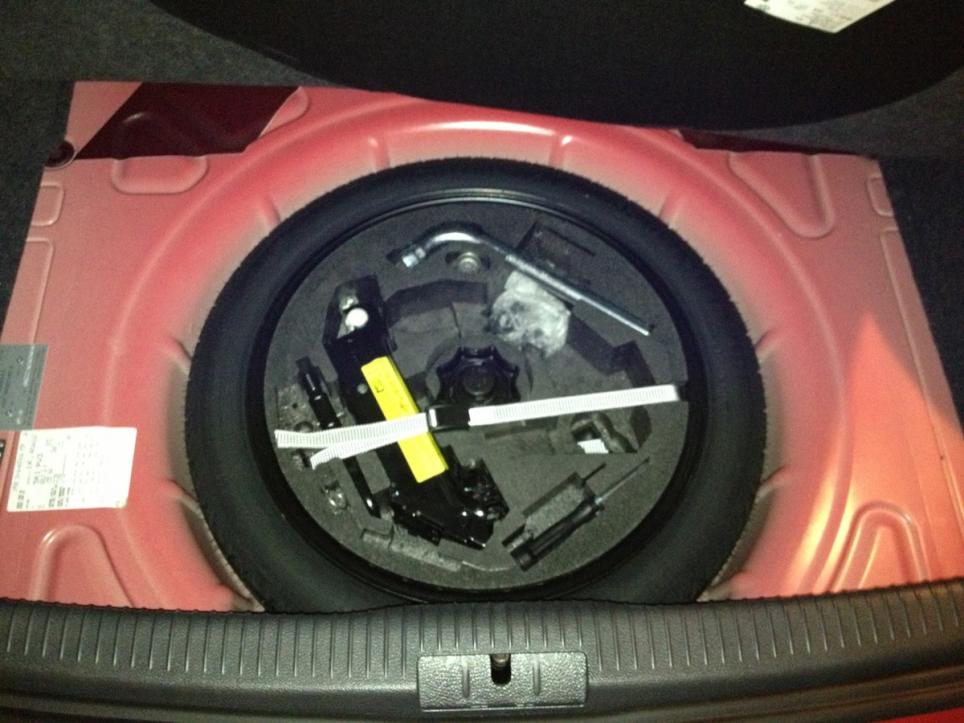

          I've just checked in the boot of my Mk6 GTI (MY10, built March 2010), and it does not have the foam inserts under the floor - the wheel well surround is solid, and non-removable. Sorry for the bad news!
          (The Golf R is likely different as it has a substantially higher boot floor than the GTI and other front-wheel-drive Golfs, due to the 4motion hardware.)

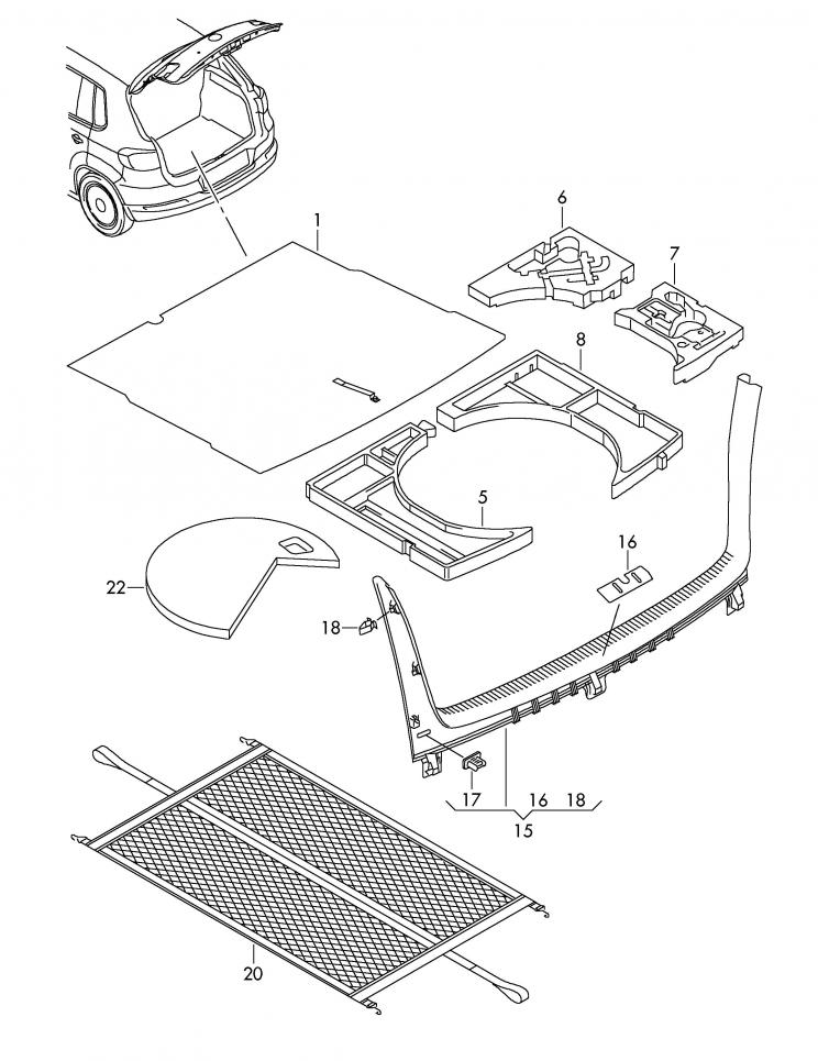

                Looks like the foam inserts are readily available on ebay, through ECS Tuning and a number of other sites online. I've identified one side as Part #1K6858858C which would suit me fine given the sub box would accommodate the other half. I don't know if there are any structural differences between the US and Australian delivered models or whether the foam trays just mean you lose a few inches of hatch depth.
                The following image shows an exploded view of how it all goes together -
                For a sacrifice of 4.25" of boot depth (the height of the Uberstealth sub box) and perhaps a touch of custom foam, I think this is still a viable option to allow for a very discrete installation of a sub to the Australian delivered MK6 GTI.

                  I'd be surprised if there were structural differences. Perhaps the foam and other inserts raise the boot floor and make a flat level surface when a full-sized spare tyre is fitted (rather than a space saver)? Is that a full-sized spare in this photo? The bottom-right corner of the boot in that photo does appear lower, and you can see the edge of the foam insert.
                    I had wondered if the difference was a full-sized spare. In the photo that you attached the wheel itself retains the stickers that outline speed restrictions which I thought was exclusive to space saving spares?
                      There are speed restrictions whenever the spare doesn't exactly match the other wheels, and it's likely those stickers will always be present just in case. Maybe that spare is a 17" and the car is fitted with 18s. The photo from Uberstealth Audio does look like a normal tyre, whereas my spare looks like it has a smaller and rounder sidewall.

                              Hi Paul,
                              That's exactly what I was thinking. The sub box and matching amp rack negate the need for the foam blocks apart from a circular piece (probably custom) that covers the tools on top of the spare wheel to bring it all up to an even height. As for the carpet; Fingers crossed that it fits no problems. The alternative is for me to pick up a new OEM liner that appears to be suited to the foam blocks (Part #1K0061166H469) which is Item 1 on this schematic -
