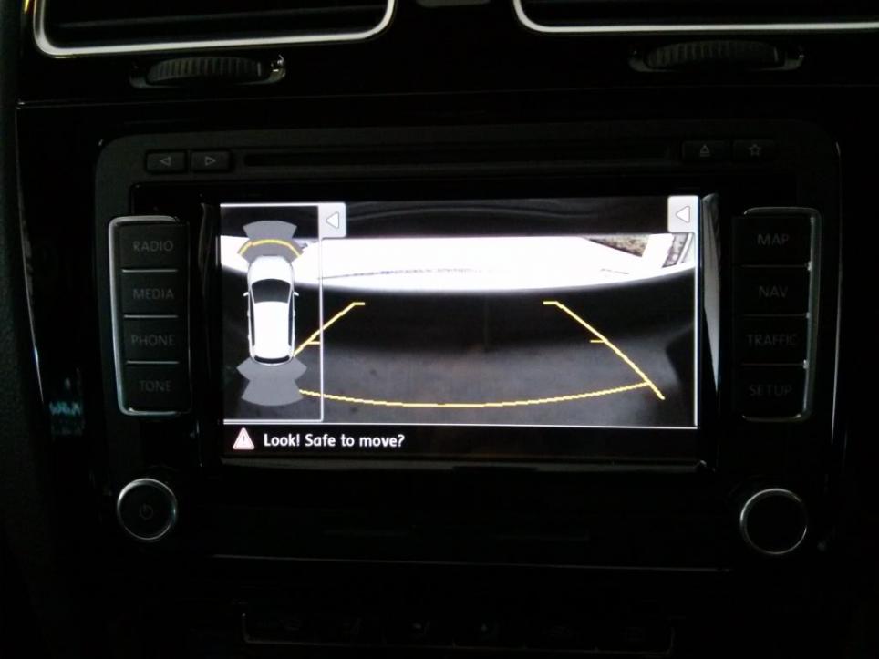

    My reverse camera doesn't seem to want to work
    When I put it in "R' the camera doesn't seem to come out all the way... Maybe less than half of the badge pops out . the display on the RNS works but it only shows what the camera can see, and since its only pops out less than half of the distance, it doesn't show much, as can be seen in the photo. The bottom half on the screen is showing the boot and the little sliver appearing on the screen is the camera showing what it can, due to it not being able to protrude out
    Anyone else have this same problem with the reverse camera being "stuck" and not having it pop out all the way? What's the fix?

      yep. no problems operating the boot...the boot still opens like it should but it seems like the flap beneath the badge where the camera lives doesnt pop out all the way, which in turn wouldnt pop out th ebadge all the way....
      the little camera is meant to come out, open the flap, and the opened flap then opens vw badge, thus being able to see...but for whatever reason it seems like the camera is stuck and cant push itself out all the way?
