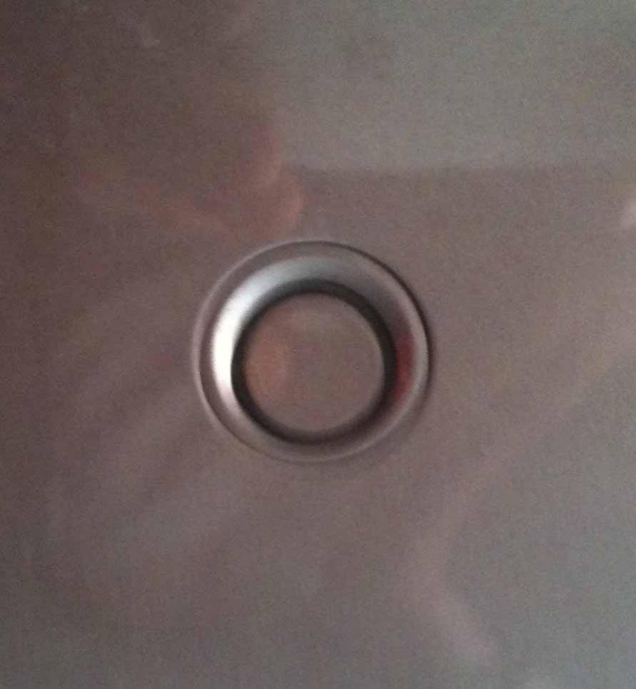

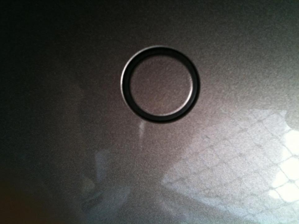

                      The car has front and rear parking sensors std.
                      The main reason I ask is more for my wifes sake and the fact that there's a parallel parking option on the screen when you place the car in reverse just like PA2 has. It does everything the same as PA2 but turn the steering wheel

                            There are 4 extra sensors on the car which look slightly different to the optical parking sensors. The sensors are all 15 mm diameter
                            Sensors at front and rear bumpers for distance parking
                            Sensors on side of bumpers front and rear for measuring parking space for size
